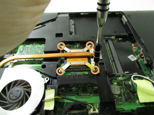

    1. Asus U50F-RBBAG05  Motherboard Replacement, Fan and Heat Sink: crwdns2935265:011crwdnd2935265:01crwdnd2935265:02crwdne2935265:0 Asus U50F-RBBAG05  Motherboard Replacement, Fan and Heat Sink: crwdns2935265:011crwdnd2935265:02crwdnd2935265:02crwdne2935265:0
      • Use the Phillips #1 to remove two screws from the fan that attach it to the motherboard.
      • Remove the four screws on the heat sink.

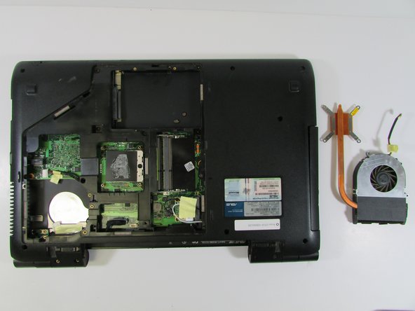

    3. Asus U50F-RBBAG05  Motherboard Replacement: crwdns2935265:013crwdnd2935265:01crwdnd2935265:02crwdne2935265:0 Asus U50F-RBBAG05  Motherboard Replacement: crwdns2935265:013crwdnd2935265:02crwdnd2935265:02crwdne2935265:0
      • Pull up the heat sink a bit and then pull back.
      • There's an overhanging piece of the lower panel near the fan that you have to scoot out of.
      • Lift and remove both the fan and heat sink.

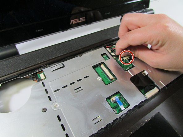

    3. Asus U50F-RBBAG05  Motherboard Replacement: crwdns2935265:022crwdnd2935265:01crwdnd2935265:03crwdne2935265:0 Asus U50F-RBBAG05  Motherboard Replacement: crwdns2935265:022crwdnd2935265:02crwdnd2935265:03crwdne2935265:0 Asus U50F-RBBAG05  Motherboard Replacement: crwdns2935265:022crwdnd2935265:03crwdnd2935265:03crwdne2935265:0
      • Pull the two bundled cables away from the connector in the same direction as the individual wires are running.
      • Potential for device damage: Pull evenly on the full width of the cable so that no individual wires are overly strained.
      • Pull the no-fuss ribbon cable straight out of the connector.
      • Potential for device damage: These kinds of connectors are fairly rare, so check carefully for a way to release the connector before you resort to pulling on the ribbon cable.
      • Pull the single bundled cable away from the connector in the same direction as the individual wires are running.

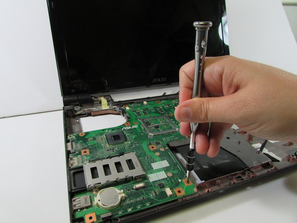

    1. Asus U50F-RBBAG05  Motherboard Replacement, Motherboard: crwdns2935265:024crwdnd2935265:01crwdnd2935265:02crwdne2935265:0 Asus U50F-RBBAG05  Motherboard Replacement, Motherboard: crwdns2935265:024crwdnd2935265:02crwdnd2935265:02crwdne2935265:0
      • Remove the six screws from the motherboard.

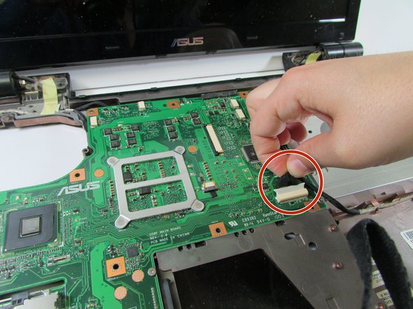

    2. Asus U50F-RBBAG05  Motherboard Replacement: crwdns2935265:025crwdnd2935265:01crwdnd2935265:03crwdne2935265:0 Asus U50F-RBBAG05  Motherboard Replacement: crwdns2935265:025crwdnd2935265:02crwdnd2935265:03crwdne2935265:0 Asus U50F-RBBAG05  Motherboard Replacement: crwdns2935265:025crwdnd2935265:03crwdnd2935265:03crwdne2935265:0
      • Pull three bundled cables away from their connectors in the same direction as the individual wires are running.
      • Potential for device damage: Pull evenly on the full width of each cable so that no individual wires are overly strained.
    3. Asus U50F-RBBAG05  Motherboard Replacement: crwdns2935265:026crwdnd2935265:01crwdnd2935265:03crwdne2935265:0 Asus U50F-RBBAG05  Motherboard Replacement: crwdns2935265:026crwdnd2935265:02crwdnd2935265:03crwdne2935265:0 Asus U50F-RBBAG05  Motherboard Replacement: crwdns2935265:026crwdnd2935265:03crwdnd2935265:03crwdne2935265:0
      • Flip the laptop over.
      • Disconnect one wire.
      • Remove the tape connected to the white wire (which should not be connected to anything, but disconnect it if it is) and disconnect the black wire.
    4. Asus U50F-RBBAG05  Motherboard Replacement: crwdns2935265:027crwdnd2935265:01crwdnd2935265:01crwdne2935265:0
      • Flip laptop back over and remove the motherboard completely.
