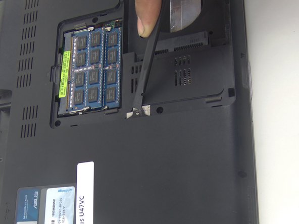

    • Remove the hard drive cover.
    • Unscrew one 8mm Phillips #00 screw.
    • Using the black spudger, insert its flat end under the hard drive's covering, working around to pry it off.

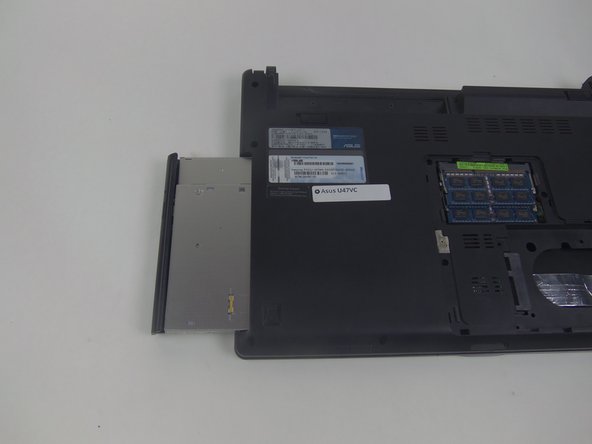

    • Unscrew the one 8mm screw using a Phillips #00.
    • Using the black spudger, slightly pry up on the tab and gently pull the optical drive away from the laptop in order to remove it.

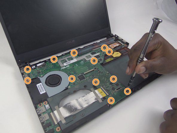

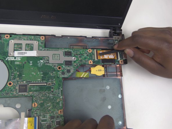

    • Using the black spudger, slowly lift up on the cable connectors and pull them away from the connectors.
    • Repeat steps on both cables.
    • Unscrew the 12 8mm screws using a Phillips #00 screwdriver.

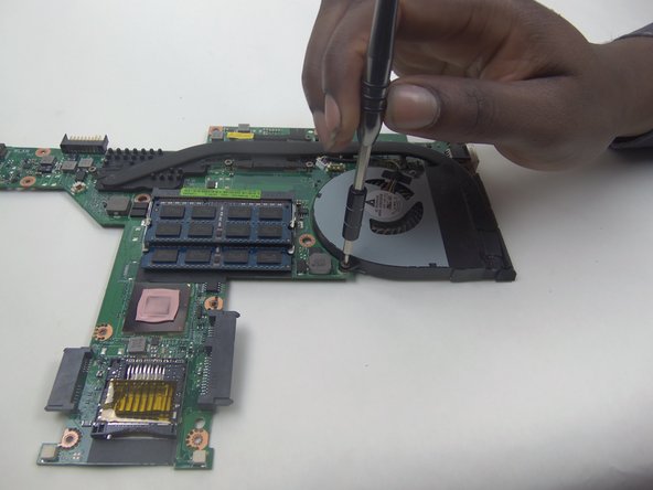

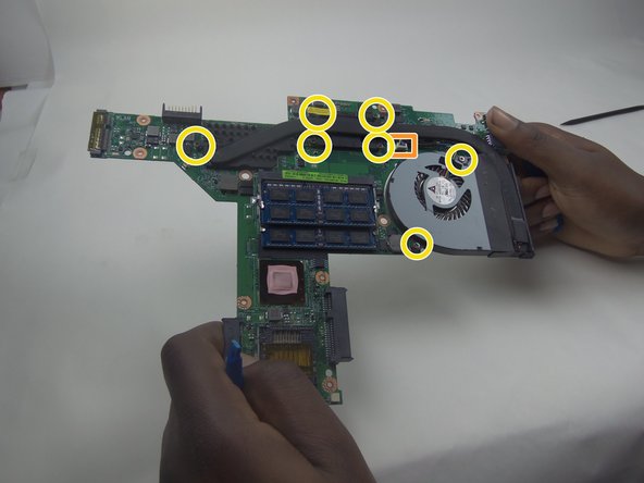

    • Lift up on the motherboard and disengage the two connectors.
    • Disconnect the cooling fan connector.
    • Unscrew the 7 8mm screws holding in the cooling fan using a Phillips #00 screwdriver.
