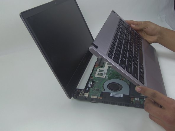

    • Remove 9 screws from bottom of notebook using PH00 bit + 1 under hard drive bay.
    • Remove 3 screws from bottom of notebook using PH00 bit. 1 is same screw spec as the other 9, and 2 are shorter.
  2. Asus U47VC-DS51 LCD Screen Replacement: crwdns2935265:02crwdnd2935265:01crwdnd2935265:02crwdne2935265:0 Asus U47VC-DS51 LCD Screen Replacement: crwdns2935265:02crwdnd2935265:02crwdnd2935265:02crwdne2935265:0
    • Using the black spudger, insert its flat end between the crevice where the color changes from grey to black.
    • The keyboard is very tightly secured.
    • Carefully ease the spudger's end along the crevice, going around the entire frame.
    • The back connectors are short, so be careful when lifting.
  3. Asus U47VC-DS51 LCD Screen Replacement: crwdns2935265:03crwdnd2935265:01crwdnd2935265:02crwdne2935265:0 Asus U47VC-DS51 LCD Screen Replacement: crwdns2935265:03crwdnd2935265:02crwdnd2935265:02crwdne2935265:0
    • Lift the keyboard from the front where it is closest to the screen.

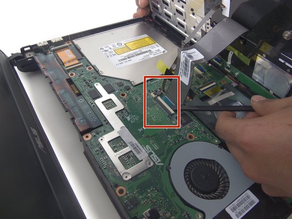

    • Disconnect the large and small ZIF connectors attached to the motherboard by flipping the light-colored part of the switch.
  4. Asus U47VC-DS51 LCD Screen Replacement: crwdns2935265:04crwdnd2935265:01crwdnd2935265:02crwdne2935265:0 Asus U47VC-DS51 LCD Screen Replacement: crwdns2935265:04crwdnd2935265:02crwdnd2935265:02crwdne2935265:0
    • Remove the third and last ZIF connector on the motherboard by flipping up the dark-colored part of the switch.
    • Now, the component should come completely free.

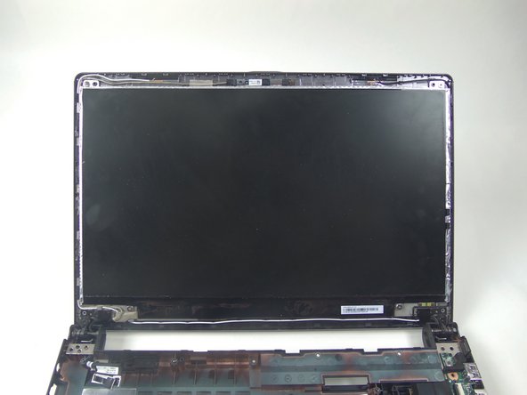

  5. Asus U47VC-DS51 LCD Screen Replacement, LCD Screen: crwdns2935265:05crwdnd2935265:01crwdnd2935265:01crwdne2935265:0
    • Unscrew the two 4mm phillips head #00 screws.

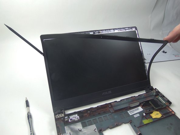

  6. Asus U47VC-DS51 LCD Screen Replacement: crwdns2935265:06crwdnd2935265:01crwdnd2935265:03crwdne2935265:0 Asus U47VC-DS51 LCD Screen Replacement: crwdns2935265:06crwdnd2935265:02crwdnd2935265:03crwdne2935265:0 Asus U47VC-DS51 LCD Screen Replacement: crwdns2935265:06crwdnd2935265:03crwdnd2935265:03crwdne2935265:0
    • Use the black spudger to pry the face plate off.
    • The face plate is attached with adhesive.
    • Gently peel the face plate from the base.

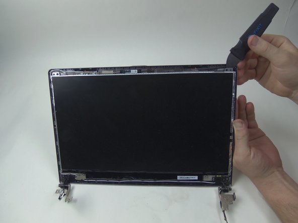

  7. Asus U47VC-DS51 LCD Screen Replacement: crwdns2935265:07crwdnd2935265:01crwdnd2935265:03crwdne2935265:0 Asus U47VC-DS51 LCD Screen Replacement: crwdns2935265:07crwdnd2935265:02crwdnd2935265:03crwdne2935265:0 Asus U47VC-DS51 LCD Screen Replacement: crwdns2935265:07crwdnd2935265:03crwdnd2935265:03crwdne2935265:0
    • Unscrew the four 3mm Phillips head #00 screws holding the screen to the base.
    • When sitting upright, the screen should fall forward from the top.

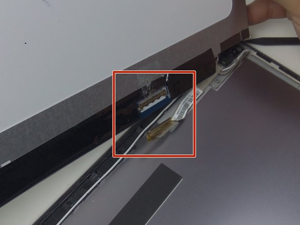

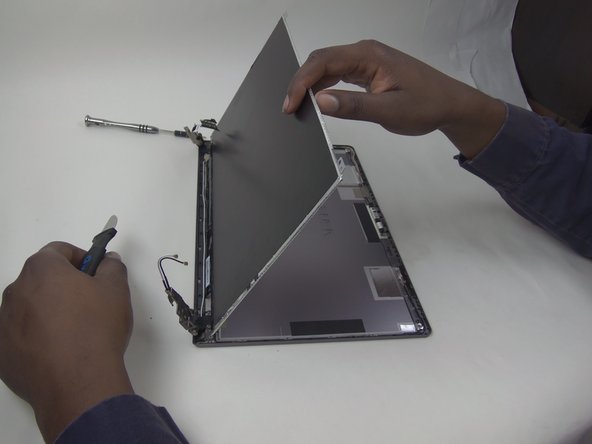

  8. Asus U47VC-DS51 LCD Screen Replacement: crwdns2935265:08crwdnd2935265:01crwdnd2935265:02crwdne2935265:0 Asus U47VC-DS51 LCD Screen Replacement: crwdns2935265:08crwdnd2935265:02crwdnd2935265:02crwdne2935265:0
    • Unease the yellow connecting tape with the spudger at the bottom of the screen.
    • Pull the connector straight down and it will disconnect fairly easy.
    • The screen should then be free to be removed.
