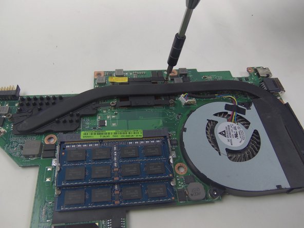

  10. Asus U47VC-DS51 Cooling Fan Replacement, Cooling fan: crwdns2935265:010crwdnd2935265:01crwdnd2935265:03crwdne2935265:0 Asus U47VC-DS51 Cooling Fan Replacement, Cooling fan: crwdns2935265:010crwdnd2935265:02crwdnd2935265:03crwdne2935265:0 Asus U47VC-DS51 Cooling Fan Replacement, Cooling fan: crwdns2935265:010crwdnd2935265:03crwdnd2935265:03crwdne2935265:0
    • Use a Phillips screwdriver to loosen the four screws holding the component in place.

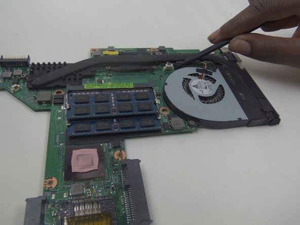

  11. Asus U47VC-DS51 Cooling Fan Replacement: crwdns2935265:011crwdnd2935265:01crwdnd2935265:01crwdne2935265:0
    • After loosening the screws, use the black spudger to help disconnect the fan wires from the connector.
  12. Asus U47VC-DS51 Cooling Fan Replacement: crwdns2935265:012crwdnd2935265:01crwdnd2935265:01crwdne2935265:0
    • The fan should then come free.
