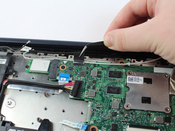

  4. Asus Transformer Flip Book TP200S WiFi Card Replacement: crwdns2935265:04crwdnd2935265:01crwdnd2935265:02crwdne2935265:0 Asus Transformer Flip Book TP200S WiFi Card Replacement: crwdns2935265:04crwdnd2935265:02crwdnd2935265:02crwdne2935265:0
    • The battery comes attached to the motherboard and needs to be disconnected before you can remove it.
    • Disconnect the battery from the motherboard by gently pulling out the connection with tweezers.
    • Gently remove the Wifi cables hooked to the rim of the battery
    • Remove the battery

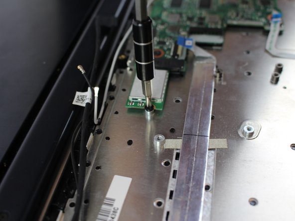

  6. Asus Transformer Flip Book TP200S WiFi Card Replacement: crwdns2935265:06crwdnd2935265:01crwdnd2935265:03crwdne2935265:0 Asus Transformer Flip Book TP200S WiFi Card Replacement: crwdns2935265:06crwdnd2935265:02crwdnd2935265:03crwdne2935265:0 Asus Transformer Flip Book TP200S WiFi Card Replacement: crwdns2935265:06crwdnd2935265:03crwdnd2935265:03crwdne2935265:0
    • Unscrew the WiFi card with a JIS #000 screwdriver.
    • Remove the motherboard connection from the WiFi card with tweezers.
    • Pull out the WiFi card.
