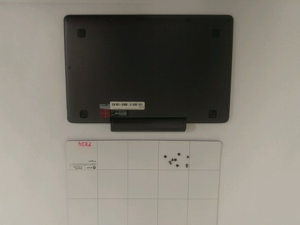

  5. Asus Transformer Book T100TAM-C1 USB Input Replacement: crwdns2935265:05crwdnd2935265:01crwdnd2935265:01crwdne2935265:0
    • Use the size 0 Phillips screwdriver and remove the nine screws from the back panel. The four you need to remove across the top are 3mm and the four across the bottom are 2.5mm.
    • The screw in the top right, shown where the screwdriver is, is a 5mm screw.

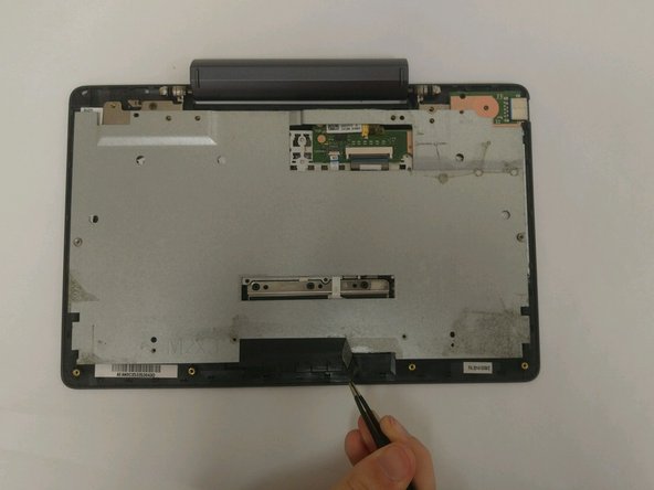

  6. Asus Transformer Book T100TAM-C1 USB Input Replacement: crwdns2935265:06crwdnd2935265:01crwdnd2935265:02crwdne2935265:0 Asus Transformer Book T100TAM-C1 USB Input Replacement: crwdns2935265:06crwdnd2935265:02crwdnd2935265:02crwdne2935265:0
    • Use tweezers and remove the black tape from the back panel.
  7. Asus Transformer Book T100TAM-C1 USB Input Replacement: crwdns2935265:07crwdnd2935265:01crwdnd2935265:01crwdne2935265:0
    • Remove the metal back panel from the keyboard.

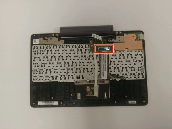

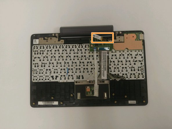

    • Flip the connectors back to release the wires
    • Take the white tab and gently pull it to the right in order to release the connecting piece.
