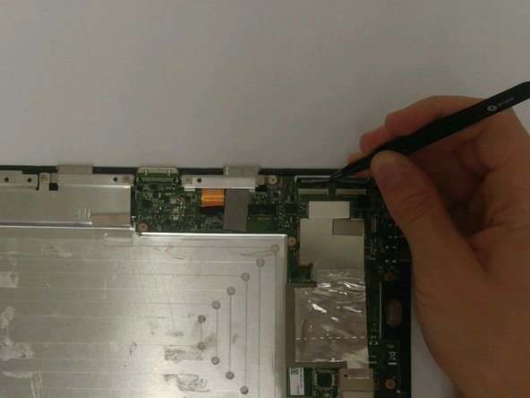

  8. Asus Transformer Book T100TAM-C1 Screen Replacement: crwdns2935265:08crwdnd2935265:01crwdnd2935265:03crwdne2935265:0 Asus Transformer Book T100TAM-C1 Screen Replacement: crwdns2935265:08crwdnd2935265:02crwdnd2935265:03crwdne2935265:0 Asus Transformer Book T100TAM-C1 Screen Replacement: crwdns2935265:08crwdnd2935265:03crwdnd2935265:03crwdne2935265:0
    • Locate the 5 different clips around the edges of the motherboard.
    • The clips will be covered by either tape or a foam piece. You will need to remove this before unlatching the clips.
    • Unlatch the connections and use tweezers to remove the cables from the connections.
    • The two remaining connections are slightly different.

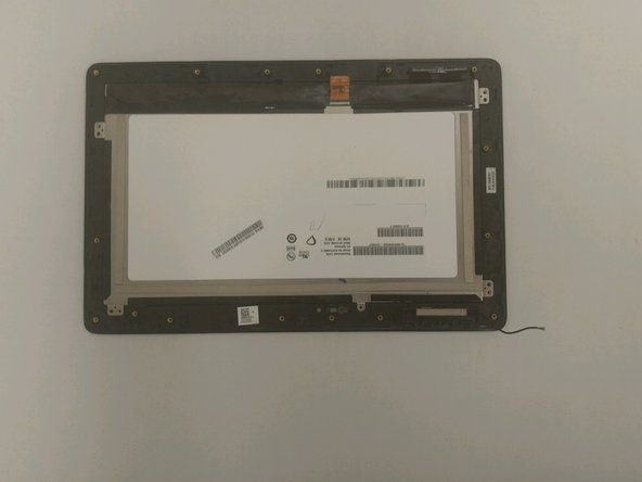

  10. Asus Transformer Book T100TAM-C1 Screen Replacement, Screen: crwdns2935265:010crwdnd2935265:01crwdnd2935265:01crwdne2935265:0
    • Once motherboard has been removed, remove the metal from the front panel.

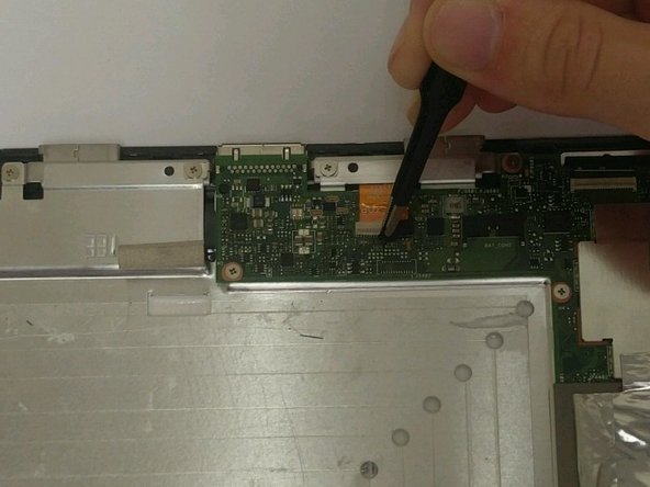

  11. Asus Transformer Book T100TAM-C1 Screen Replacement: crwdns2935265:011crwdnd2935265:01crwdnd2935265:02crwdne2935265:0 Asus Transformer Book T100TAM-C1 Screen Replacement: crwdns2935265:011crwdnd2935265:02crwdnd2935265:02crwdne2935265:0
    • Using tweezers, remove the yellow tape that is covering the orange ribbon wire.
    • Flip the connector for the orange ribbon wire, and gently pull that end out of the socket.

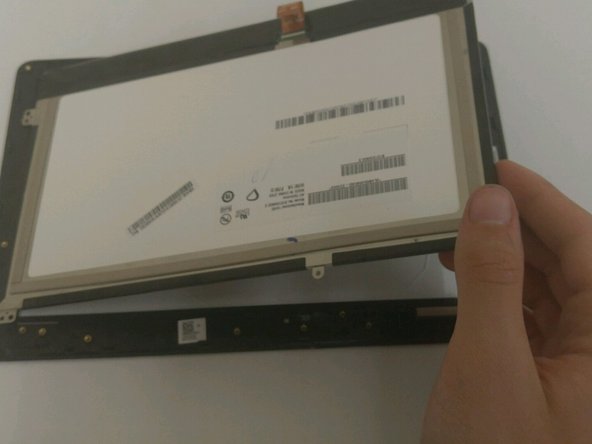

  13. Asus Transformer Book T100TAM-C1 Screen Replacement: crwdns2935265:013crwdnd2935265:01crwdnd2935265:01crwdne2935265:0
    • Place the iOpener microwave piece in the microwave for the suggested amount of time.
    • The suggested amount of time will be on the iOpener microwave piece.
    • Follow the directions on the iOpener microwave piece for safe removal so you do not burn yourself, as it will be very hot.
    • Place along the edges until the tape has been melted, therefore releasing the screen from the frame.
    • Remove old frame and replace with the new one.
