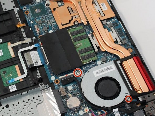

  5. Asus TUF Gaming FX705G Fan Replacement, Fan: crwdns2935265:05crwdnd2935265:01crwdnd2935265:02crwdne2935265:0 Asus TUF Gaming FX705G Fan Replacement, Fan: crwdns2935265:05crwdnd2935265:02crwdnd2935265:02crwdne2935265:0
    • Remove the five Phillips #00 screws from the fan casings.
    • The left fan has three screws and the right fan has two screws.

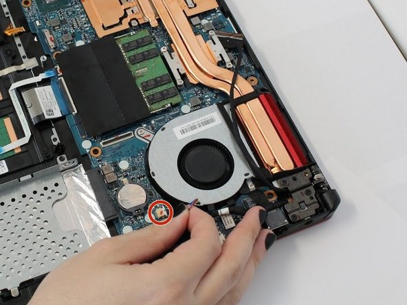

  6. Asus TUF Gaming FX705G Fan Replacement: crwdns2935265:06crwdnd2935265:01crwdnd2935265:03crwdne2935265:0 Asus TUF Gaming FX705G Fan Replacement: crwdns2935265:06crwdnd2935265:02crwdnd2935265:03crwdne2935265:0 Asus TUF Gaming FX705G Fan Replacement: crwdns2935265:06crwdnd2935265:03crwdnd2935265:03crwdne2935265:0
    • Unplug the cables that connect the fan to the motherboard.

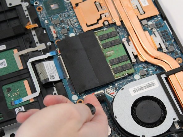

  7. Asus TUF Gaming FX705G Fan Replacement: crwdns2935265:07crwdnd2935265:01crwdnd2935265:03crwdne2935265:0 Asus TUF Gaming FX705G Fan Replacement: crwdns2935265:07crwdnd2935265:02crwdnd2935265:03crwdne2935265:0 Asus TUF Gaming FX705G Fan Replacement: crwdns2935265:07crwdnd2935265:03crwdnd2935265:03crwdne2935265:0
    • Lift the motherboard to unclip the housing clip on the back of the fan.
    • Remove the fan.
