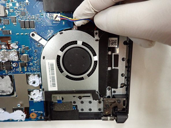

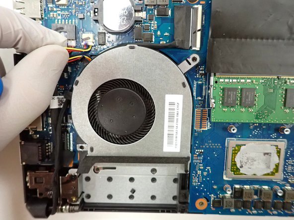

  5. Asus TUF Gaming FX505DY Heat Sink & Fan Replacement, Heat Sink & Fan: crwdns2935265:05crwdnd2935265:01crwdnd2935265:03crwdne2935265:0 Asus TUF Gaming FX505DY Heat Sink & Fan Replacement, Heat Sink & Fan: crwdns2935265:05crwdnd2935265:02crwdnd2935265:03crwdne2935265:0 Asus TUF Gaming FX505DY Heat Sink & Fan Replacement, Heat Sink & Fan: crwdns2935265:05crwdnd2935265:03crwdnd2935265:03crwdne2935265:0
    • With a Phillips 0-bit screwdriver, remove eight 5.0 mm screws on the silver brackets
    • With a Phillips 0-bit screwdriver, remove two 5.0 mm screws holding the edge of the fans in place
  6. Asus TUF Gaming FX505DY Heat Sink & Fan Replacement: crwdns2935265:06crwdnd2935265:01crwdnd2935265:03crwdne2935265:0 Asus TUF Gaming FX505DY Heat Sink & Fan Replacement: crwdns2935265:06crwdnd2935265:02crwdnd2935265:03crwdne2935265:0 Asus TUF Gaming FX505DY Heat Sink & Fan Replacement: crwdns2935265:06crwdnd2935265:03crwdnd2935265:03crwdne2935265:0
    • Disconnect two power cables connecting fans to the motherboard.
    • Once all cables and screws are removed, carefully lift up and remove the fans and heat sink
