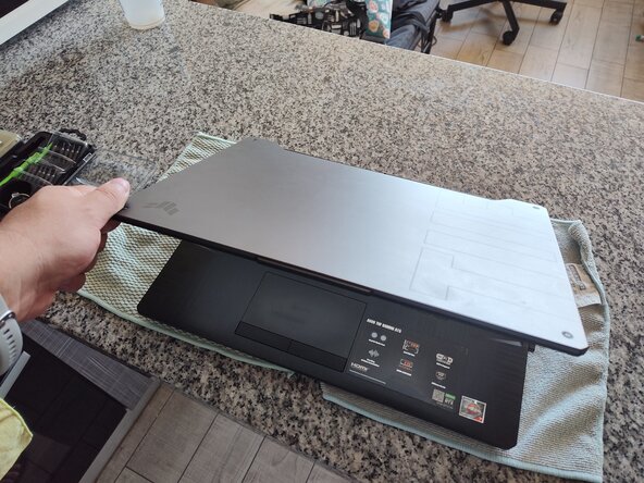

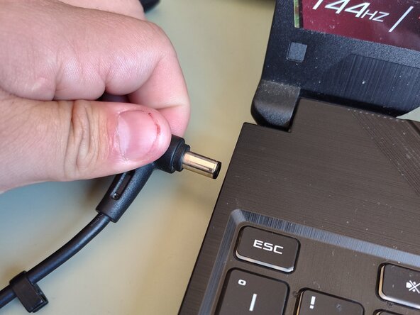

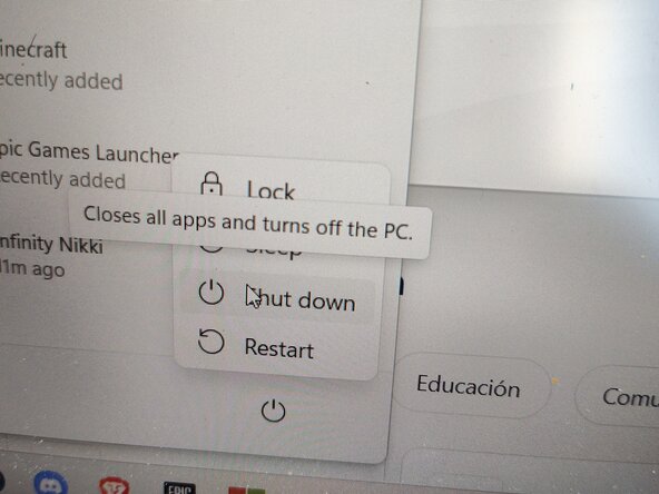

    • Disconnect the charger and turn off the device.
  2. Asus TUF Gaming A15 FA506QM Back Cover Replacement, Check peripherals: crwdns2935265:02crwdnd2935265:01crwdnd2935265:03crwdne2935265:0 Asus TUF Gaming A15 FA506QM Back Cover Replacement, Check peripherals: crwdns2935265:02crwdnd2935265:02crwdnd2935265:03crwdne2935265:0 Asus TUF Gaming A15 FA506QM Back Cover Replacement, Check peripherals: crwdns2935265:02crwdnd2935265:03crwdnd2935265:03crwdne2935265:0
    • Close the lid.

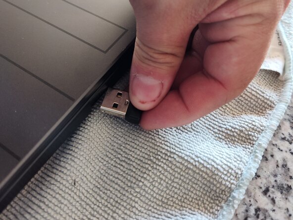

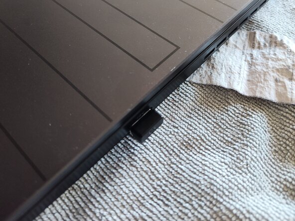

    • Make sure to take out any USB peripherals before continuing.

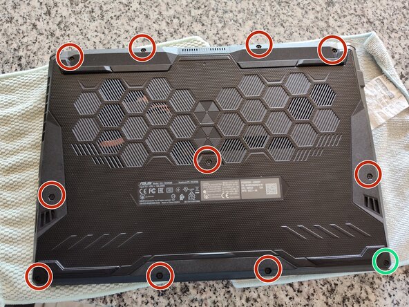

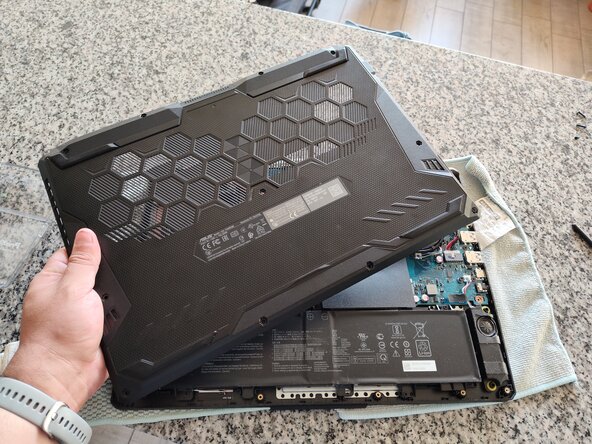

    • The bottom-right screw (pictured in green) is captive. Don't force it out.
    • Remove the 11 screws. Make sure to keep them organized.

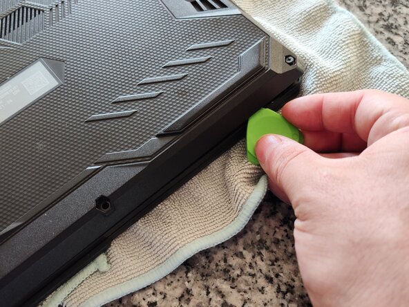

    • Using a plastic spudger, undo the clips until the casing start to loosen.
    • Remove the casing and set it aside.
  4. Asus TUF Gaming A15 FA506QM Back Cover Replacement: crwdns2935265:04crwdnd2935265:01crwdnd2935265:03crwdne2935265:0 Asus TUF Gaming A15 FA506QM Back Cover Replacement: crwdns2935265:04crwdnd2935265:02crwdnd2935265:03crwdne2935265:0 Asus TUF Gaming A15 FA506QM Back Cover Replacement: crwdns2935265:04crwdnd2935265:03crwdnd2935265:03crwdne2935265:0

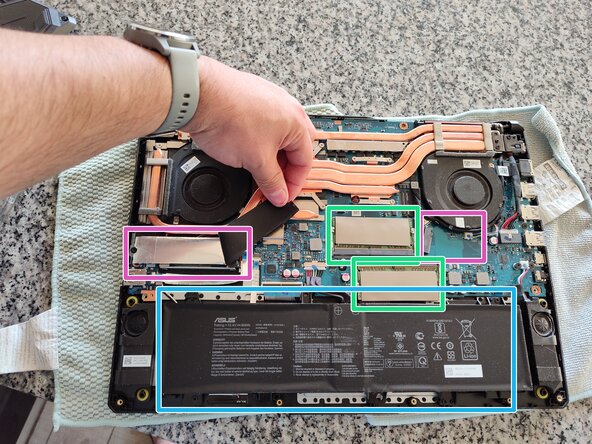

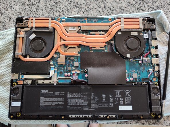

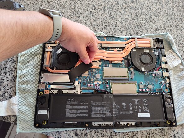

    • The first picture shows how it looks as you open it. It has a couple of thin black plastic covers.
    • You can remove these plasic covers to gain access to:
    • 2 PCIe 3.0 NVMe M.2 SSD Slots (Pictured in Purple). It uses a 2280 format size.
    • 2 SO-DIMM DDR4 Slots (Pictured in Green)
    • 90 Wh Battery (Pictured in Blue)
Congratulations! You gained access to your laptop internals. Now, you can reassemble by following the steps in reverse! Good Luck.
