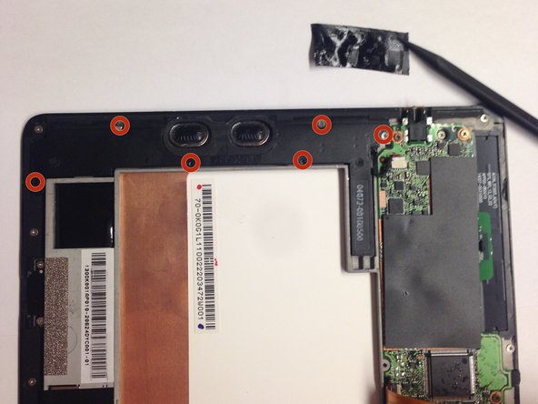

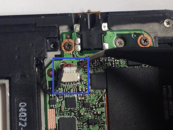

    • After the battery has been removed, remove the black tape next to the speaker using the spudger.
    • When the tape is removed, remove all the 3mm screws holding the speaker unit in place with the Phillips #00 screwdriver.
    • Using the tweezers, remove the speaker unit from its clip as shown in the picture by pulling on the part with the wire coming out of it.
