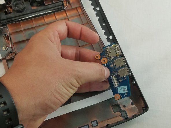

  5. Asus Rog GL55VW-DH71 USB port Replacement, USB port: crwdns2935265:05crwdnd2935265:01crwdnd2935265:02crwdne2935265:0 Asus Rog GL55VW-DH71 USB port Replacement, USB port: crwdns2935265:05crwdnd2935265:02crwdnd2935265:02crwdne2935265:0
    • The pictures shown are taken with the motherboard removed. This is not required for the replacement of the USB module.
    • Remove the two 2.8mm Phillips #00 screws.
    • Carefully remove the ZIF connector ribbon cable from the module by lifting up on the latch and pulling the cable out.
