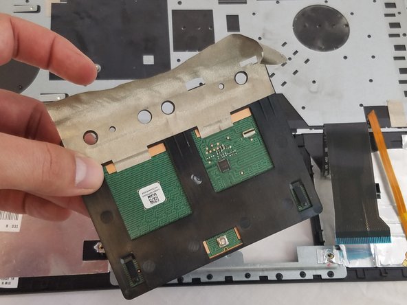

  5. Asus Rog GL55VW-DH71 Touchpad Replacement, Touchpad: crwdns2935265:05crwdnd2935265:01crwdnd2935265:01crwdne2935265:0
    • Remove the ZIF connector ribbon cable from the back of the touchpad by carefully lifting the latch on the connector and sliding the cable out.
  6. Asus Rog GL55VW-DH71 Touchpad Replacement: crwdns2935265:06crwdnd2935265:01crwdnd2935265:01crwdne2935265:0
    • Remove the three 2.8mm Phillips #00 screws from the trackpad.

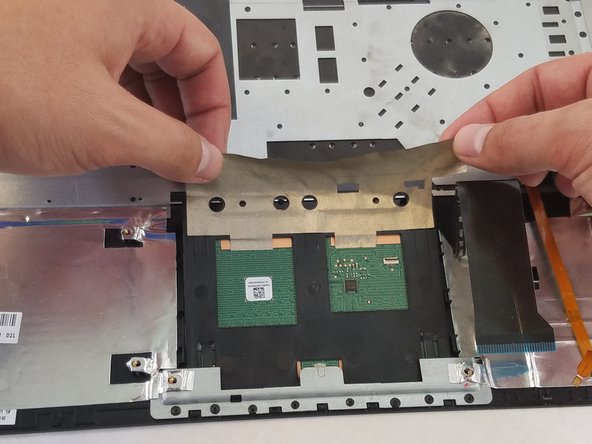

  7. Asus Rog GL55VW-DH71 Touchpad Replacement: crwdns2935265:07crwdnd2935265:01crwdnd2935265:03crwdne2935265:0 Asus Rog GL55VW-DH71 Touchpad Replacement: crwdns2935265:07crwdnd2935265:02crwdnd2935265:03crwdne2935265:0 Asus Rog GL55VW-DH71 Touchpad Replacement: crwdns2935265:07crwdnd2935265:03crwdnd2935265:03crwdne2935265:0
    • Remove the tape.
    • Pull the touchpad out of the assembly.
