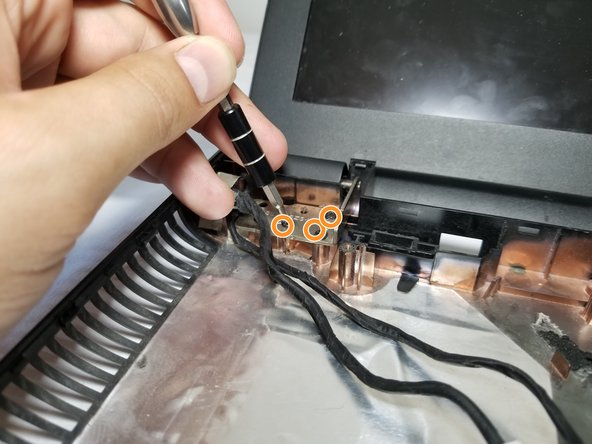

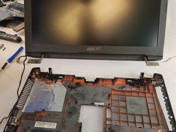

    1. Asus Rog GL55VW-DH71 Screen Replacement, Screen: crwdns2935265:09crwdnd2935265:01crwdnd2935265:02crwdne2935265:0 Asus Rog GL55VW-DH71 Screen Replacement, Screen: crwdns2935265:09crwdnd2935265:02crwdnd2935265:02crwdne2935265:0
      • Using the Phillips Screwdriver #00, remove the 3 8.5mm screws to disconnect the right side hinge from the assembly.
      • Remove the 3 8.5mm screws to disconnect the left side hinge from the assembly.

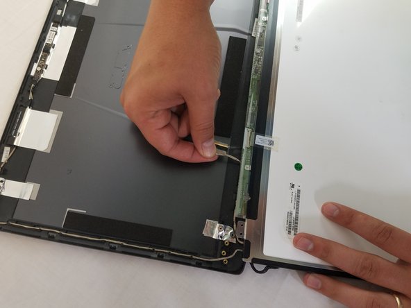

    2. Asus Rog GL55VW-DH71 Screen Replacement: crwdns2935265:010crwdnd2935265:01crwdnd2935265:02crwdne2935265:0 Asus Rog GL55VW-DH71 Screen Replacement: crwdns2935265:010crwdnd2935265:02crwdnd2935265:02crwdne2935265:0
      • Remove the tape holding the power cable down and trace and remove the cables for the LCD from the assembly.
      • Set the assembly aside and all that should be left is the screen.

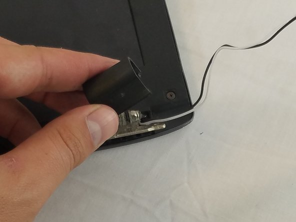

    3. Asus Rog GL55VW-DH71 Screen Replacement: crwdns2935265:011crwdnd2935265:01crwdnd2935265:02crwdne2935265:0 Asus Rog GL55VW-DH71 Screen Replacement: crwdns2935265:011crwdnd2935265:02crwdnd2935265:02crwdne2935265:0
      • Remove the black hinge covers on each side. They just pop on and off with some force.

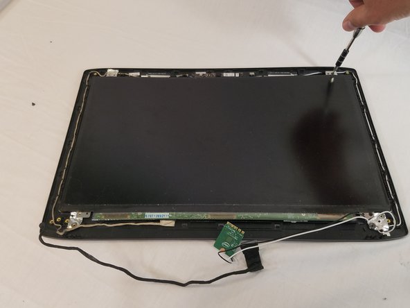

    5. Asus Rog GL55VW-DH71 Screen Replacement: crwdns2935265:013crwdnd2935265:01crwdnd2935265:03crwdne2935265:0 Asus Rog GL55VW-DH71 Screen Replacement: crwdns2935265:013crwdnd2935265:02crwdnd2935265:03crwdne2935265:0 Asus Rog GL55VW-DH71 Screen Replacement: crwdns2935265:013crwdnd2935265:03crwdnd2935265:03crwdne2935265:0
      • Using the Phillips Screwdriver #00, remove the 4 3.4mm screws that hold the screen to the top plate.
      • Trace the wires through the holders and remove the LCD.
      • Replace with new screen.
