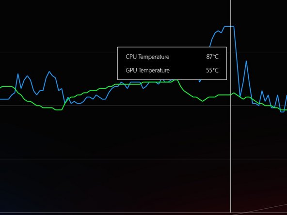

  6. Asus ROG Zephyrus G14 Thermal Paste Replacement, Temps before: crwdns2935265:07crwdnd2935265:01crwdnd2935265:02crwdne2935265:0 Asus ROG Zephyrus G14 Thermal Paste Replacement, Temps before: crwdns2935265:07crwdnd2935265:02crwdnd2935265:02crwdne2935265:0
    • Before new paste.
  7. Asus ROG Zephyrus G14 Thermal Paste Replacement, The results: crwdns2935265:08crwdnd2935265:01crwdnd2935265:03crwdne2935265:0 Asus ROG Zephyrus G14 Thermal Paste Replacement, The results: crwdns2935265:08crwdnd2935265:02crwdnd2935265:03crwdne2935265:0 Asus ROG Zephyrus G14 Thermal Paste Replacement, The results: crwdns2935265:08crwdnd2935265:03crwdnd2935265:03crwdne2935265:0

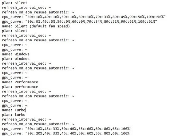

    • After new Thermal paste.
    • For the testing, I used 3D mark time spy without the demo. As well as a custom fan curve. The profile was set to turbo for both runs.
