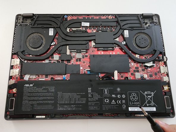

    • Flip laptop so the back cover faces up.
    • Remove the ten (M2x9) screws.
    • Remove the three (M2x4.5) screw.
    • Loosen (M2.5x6) pop-open screw without removing screw from the cover.
    • Pop-open screw CANNOT be removed. Do NOT try and remove it with any other tool. This can damage the screw and/or back cover.

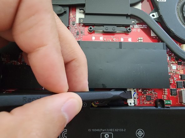

    • Place iFixit opening tool at the pop-open screw (bottom right screw), there will be a gap there to place your tool.
    • Pry your way around the perimeter of the laptop.
    • Plastic clips holding the back cover will pop free as you pry. You will hear popping noises. This is normal.
    • During reassembly push down around the perimeter of the back cover to snap the plastic clips into place.

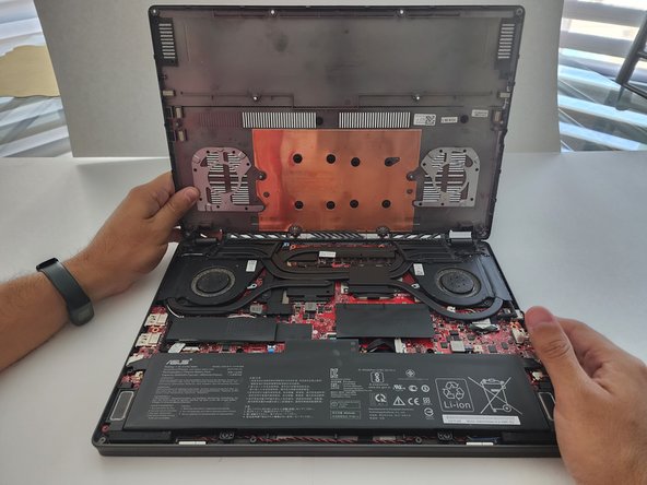

    • Gently lift the back cover open and remove it.
    • Plastic clips in the center of the cover will pop free when lifting the cover. Hearing popping noises and feeling some resistance is normal.
    • During reassembly, push down at the center of the cover with your hands and the hooks will snap back into place.

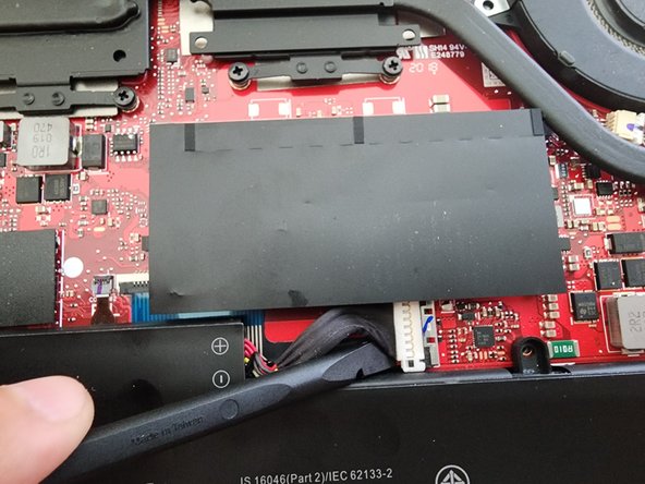

    • Use the plastic spudger to gently slide back the metal retaining clasp from the connector.
    • Place your spudger under the connector and carefully pry each side up.
    • DO NOT use any metal tool for this step. Doing so may cause sparks and a short circuit to occur damaging your laptop.
