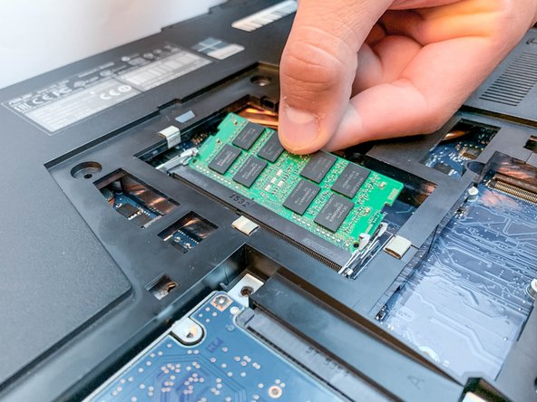

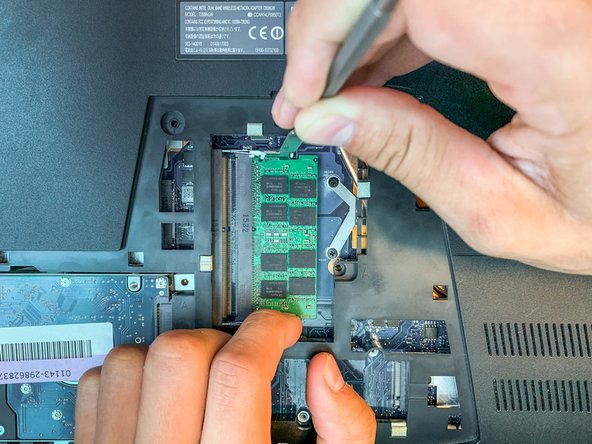

    • Use your fingers or plastic spudger to unlatch the two metal clips on either side of the RAM. It will then pop up to a 35 degree angle for removal.
    • Using a metal spudger may severely damage the internal components of your device.
