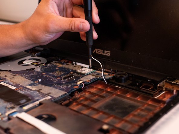

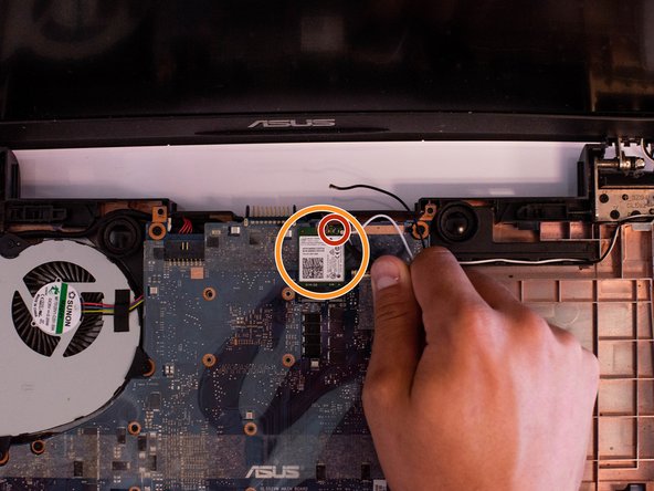

    • Detach the black and white plugs from the motherboard.
    • Remove the wireless AC chip from the motherboard using the tweezers.

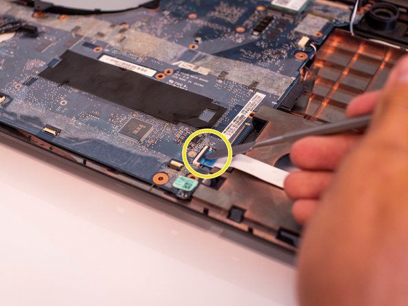

    • Detach the last ribbon from the motherboard.

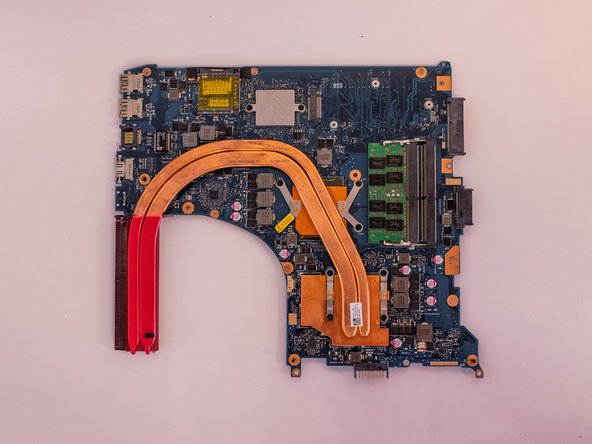

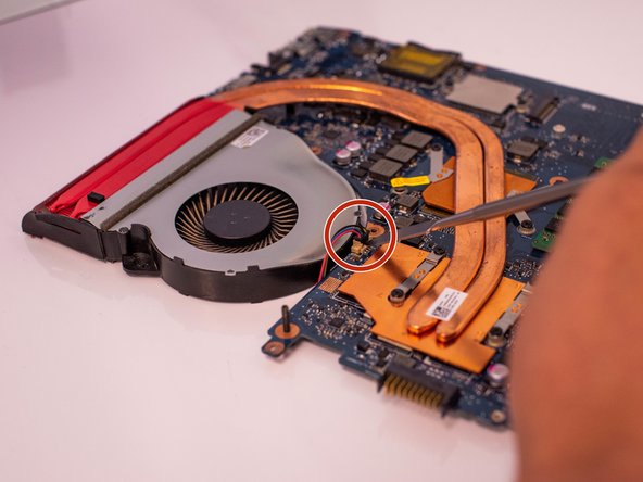

    • Carefully flip the motherboard over and place it down flat.
    • Detach the plug from the motherboard and remove the fan.
