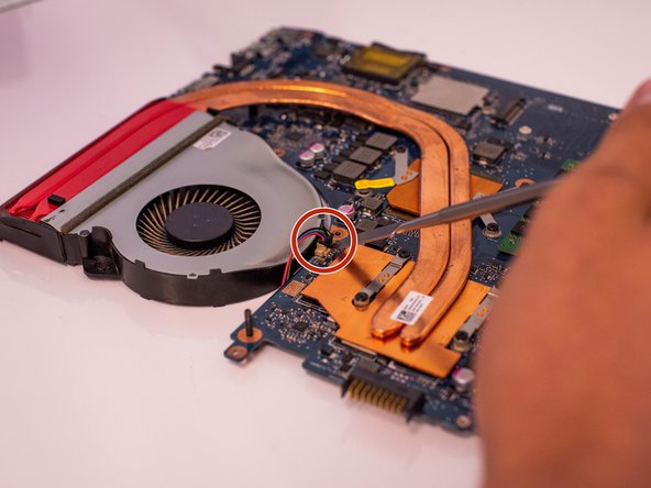

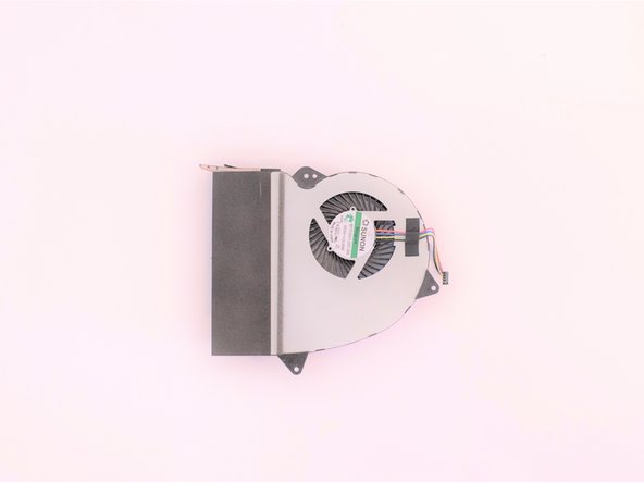

  10. Asus ROG ZX50VW-BH17N10 Fan Replacement: crwdns2935265:010crwdnd2935265:01crwdnd2935265:03crwdne2935265:0 Asus ROG ZX50VW-BH17N10 Fan Replacement: crwdns2935265:010crwdnd2935265:02crwdnd2935265:03crwdne2935265:0 Asus ROG ZX50VW-BH17N10 Fan Replacement: crwdns2935265:010crwdnd2935265:03crwdnd2935265:03crwdne2935265:0
    • Carefully flip the motherboard over and place it down flat.
    • Detach the plug from the motherboard and remove the fan.
    • Using the metal spudger may severely damage the internal components of a device.
