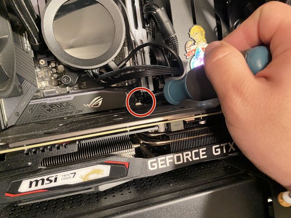

    • Remove the front panel.
    • This may involve one or two thumb screws depending on your case.
  2. Asus ROG Strix X570-I Mini ITX Motherboard M.2 SSD Replacement: crwdns2935265:02crwdnd2935265:01crwdnd2935265:01crwdne2935265:0
    • Detach the PSU cable from your graphics card.
  3. Asus ROG Strix X570-I Mini ITX Motherboard M.2 SSD Replacement: crwdns2935265:03crwdnd2935265:01crwdnd2935265:03crwdne2935265:0 Asus ROG Strix X570-I Mini ITX Motherboard M.2 SSD Replacement: crwdns2935265:03crwdnd2935265:02crwdnd2935265:03crwdne2935265:0 Asus ROG Strix X570-I Mini ITX Motherboard M.2 SSD Replacement: crwdns2935265:03crwdnd2935265:03crwdnd2935265:03crwdne2935265:0
    • Unscrew the back panel screws to release the graphics card.
    • Release the PCIe switch.
    • Be careful when using a tool as you can damage the motherboard if the tool slips.
    • Take the graphics card out vertically.
  4. Asus ROG Strix X570-I Mini ITX Motherboard M.2 SSD Replacement: crwdns2935265:04crwdnd2935265:01crwdnd2935265:03crwdne2935265:0 Asus ROG Strix X570-I Mini ITX Motherboard M.2 SSD Replacement: crwdns2935265:04crwdnd2935265:02crwdnd2935265:03crwdne2935265:0 Asus ROG Strix X570-I Mini ITX Motherboard M.2 SSD Replacement: crwdns2935265:04crwdnd2935265:03crwdnd2935265:03crwdne2935265:0
    • Unscrew the heat-sink screws.
    • Remove the heat-sink vertically.
    • It is important to remove it vertically as there are pins on the right side that must not be bent.
  5. Asus ROG Strix X570-I Mini ITX Motherboard M.2 SSD Replacement: crwdns2935265:05crwdnd2935265:01crwdnd2935265:03crwdne2935265:0 Asus ROG Strix X570-I Mini ITX Motherboard M.2 SSD Replacement: crwdns2935265:05crwdnd2935265:02crwdnd2935265:03crwdne2935265:0 Asus ROG Strix X570-I Mini ITX Motherboard M.2 SSD Replacement: crwdns2935265:05crwdnd2935265:03crwdnd2935265:03crwdne2935265:0
    • Unscrew the small screw holding the SSD.
    • Remove the SSD at an angle.
    • Be careful to avoid grabbing the SSD from its circuit.
    • Insert a new SSD at a 30-40 degree angle.
