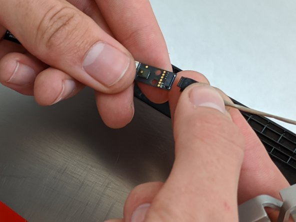

  7. Asus ROG Strix GL702VS Webcam Replacement, Webcam: crwdns2935265:07crwdnd2935265:01crwdnd2935265:01crwdne2935265:0
    • Gently lift the webcam out of its resting position at the top of the LCD assembly.
  8. Asus ROG Strix GL702VS Webcam Replacement: crwdns2935265:08crwdnd2935265:01crwdnd2935265:02crwdne2935265:0 Asus ROG Strix GL702VS Webcam Replacement: crwdns2935265:08crwdnd2935265:02crwdnd2935265:02crwdne2935265:0
    • Using the nylon tweezers or your hand, disconnect the webcam module.
