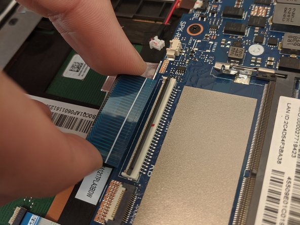

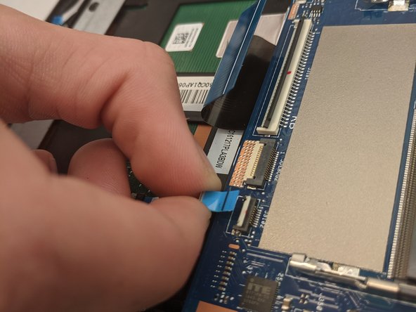

      • Disconnect the ribbon cables from the connectors at the bottom of the motherboard by lifting up the tabs with a nylon spudger tool.
      • Slide the ribbon cables out of the connectors on the motherboard.

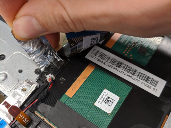

      • Remove the covering foil holding the trackpad into place.
      • Completely peel the foil back to ensure it does not interfere with the following processes.

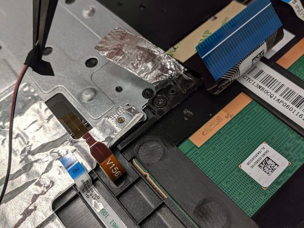

      • Lift up speaker cable that is laying overtop using a pair of tweezers.
      • Do not to overextend the wire since you may accidently pull the wire out.

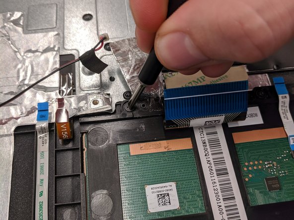

      • Remove the three 4mm JIS #0 screws that are securing the trackpad.
