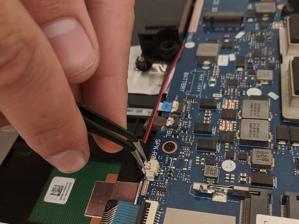

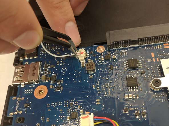

  5. Asus ROG Strix GL702VS Speaker Replacement, Speaker: crwdns2935265:05crwdnd2935265:01crwdnd2935265:03crwdne2935265:0 Asus ROG Strix GL702VS Speaker Replacement, Speaker: crwdns2935265:05crwdnd2935265:02crwdnd2935265:03crwdne2935265:0 Asus ROG Strix GL702VS Speaker Replacement, Speaker: crwdns2935265:05crwdnd2935265:03crwdnd2935265:03crwdne2935265:0
    • Disconnect the two sets of speaker connectors using a pair of tweezers.
