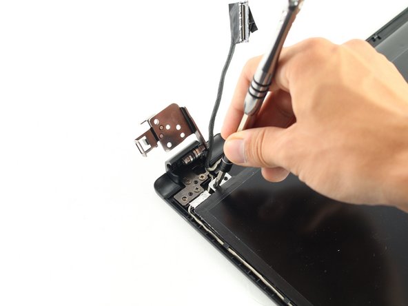

  3. Asus ROG Strix GL702VM-BHI7N09 Screen Replacement, Screen: crwdns2935265:03crwdnd2935265:01crwdnd2935265:01crwdne2935265:0
    • Using a Phillips #1 screwdriver, remove the two 6 mm screws that hold the hinge.
  4. Asus ROG Strix GL702VM-BHI7N09 Screen Replacement: crwdns2935265:04crwdnd2935265:01crwdnd2935265:01crwdne2935265:0
    • Repeat Step 3 on the opposite hinge.

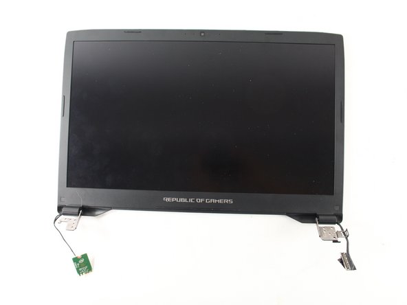

    • Using a Phillips #1 screwdriver, remove the one 4 mm screw from the motherboard to release the Intel chip.
  6. Asus ROG Strix GL702VM-BHI7N09 Screen Replacement: crwdns2935265:06crwdnd2935265:01crwdnd2935265:01crwdne2935265:0
    • Disconnect the chip from the motherboard by pulling it gently toward the laptop hinges.
  7. Asus ROG Strix GL702VM-BHI7N09 Screen Replacement: crwdns2935265:07crwdnd2935265:01crwdnd2935265:01crwdne2935265:0
    • Disconnect the black wire adjacent to the fan from the motherboard by gently pulling it upward.
    • You may hear some small clicks, but don't worry; it's just the pins disconnecting.

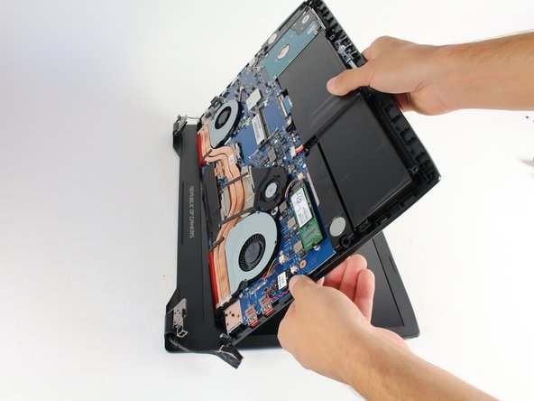

  8. Asus ROG Strix GL702VM-BHI7N09 Screen Replacement: crwdns2935265:08crwdnd2935265:01crwdnd2935265:03crwdne2935265:0 Asus ROG Strix GL702VM-BHI7N09 Screen Replacement: crwdns2935265:08crwdnd2935265:02crwdnd2935265:03crwdne2935265:0 Asus ROG Strix GL702VM-BHI7N09 Screen Replacement: crwdns2935265:08crwdnd2935265:03crwdnd2935265:03crwdne2935265:0
    • While holding down the screen, lift the base of the laptop to an angle between 45 and 90 degrees.
    • Remove the screen from the base by gently pulling the base in the direction of the screen, parallel to the ground.

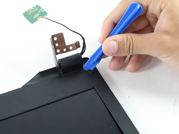

    • Using the blue plastic opening tool, pry up the squares that cover two screws on the front of the screen.
  10. Asus ROG Strix GL702VM-BHI7N09 Screen Replacement: crwdns2935265:010crwdnd2935265:01crwdnd2935265:01crwdne2935265:0

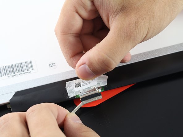

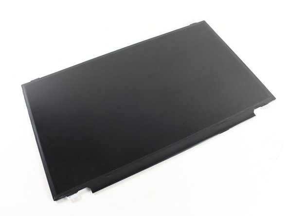

  14. Asus ROG Strix GL702VM-BHI7N09 Screen Replacement: crwdns2935265:014crwdnd2935265:01crwdnd2935265:03crwdne2935265:0 Asus ROG Strix GL702VM-BHI7N09 Screen Replacement: crwdns2935265:014crwdnd2935265:02crwdnd2935265:03crwdne2935265:0 Asus ROG Strix GL702VM-BHI7N09 Screen Replacement: crwdns2935265:014crwdnd2935265:03crwdnd2935265:03crwdne2935265:0
    • Gently peel off the tape over the wire connection.
    • If you can't grip it, try using the opening tool to lift up an edge of the tape.
    • Disconnect the wire by pulling it directly away from the screen.
    • The screen is now fully disconnected and can be removed from its case.
