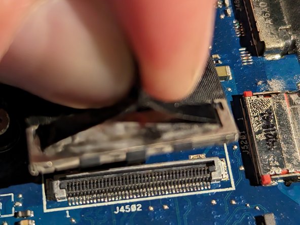

  14. Asus ROG STRIX GL502V Motherboard Replacement, Display connector: crwdns2935265:014crwdnd2935265:01crwdnd2935265:02crwdne2935265:0 Asus ROG STRIX GL502V Motherboard Replacement, Display connector: crwdns2935265:014crwdnd2935265:02crwdnd2935265:02crwdne2935265:0
    • Pull display connector straight up by the pull strap

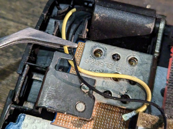

  19. Asus ROG STRIX GL502V Motherboard Replacement, Motherboard screws: crwdns2935265:019crwdnd2935265:01crwdnd2935265:01crwdne2935265:0
    • Remove two side motherboard screws (yellow marks)
    • Remove 4 center screws (green marks)
    • Note: side screws silver and slighter longer.
