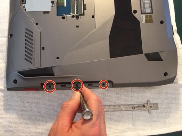

  2. Asus ROG Laptop G752VL-DH71 RAM under keyboard Replacement, Back panel removal part 1, remove rubber plugs: crwdns2935265:02crwdnd2935265:01crwdnd2935265:03crwdne2935265:0 Asus ROG Laptop G752VL-DH71 RAM under keyboard Replacement, Back panel removal part 1, remove rubber plugs: crwdns2935265:02crwdnd2935265:02crwdnd2935265:03crwdne2935265:0 Asus ROG Laptop G752VL-DH71 RAM under keyboard Replacement, Back panel removal part 1, remove rubber plugs: crwdns2935265:02crwdnd2935265:03crwdnd2935265:03crwdne2935265:0
    • Remove 11 rubber plugs with small straight head screw driver.
    • I place all screws and plugs on a piece of tape sticky side up and label where they go.
  3. Asus ROG Laptop G752VL-DH71 RAM under keyboard Replacement, Back panel removal part 2, screw removal: crwdns2935265:03crwdnd2935265:01crwdnd2935265:02crwdne2935265:0 Asus ROG Laptop G752VL-DH71 RAM under keyboard Replacement, Back panel removal part 2, screw removal: crwdns2935265:03crwdnd2935265:02crwdnd2935265:02crwdne2935265:0
    • Remove 7, 1cm screws.
    • Remove 5, M2.5x6 screws.

  5. Asus ROG Laptop G752VL-DH71 RAM under keyboard Replacement, Back panel removal part 4, screw removal: crwdns2935265:05crwdnd2935265:01crwdnd2935265:02crwdne2935265:0 Asus ROG Laptop G752VL-DH71 RAM under keyboard Replacement, Back panel removal part 4, screw removal: crwdns2935265:05crwdnd2935265:02crwdnd2935265:02crwdne2935265:0
    • Remove 4, 1/4cm screws from bottom row.
    • Remove 3, 1/3cm screws from under where you pulled out optical drive.

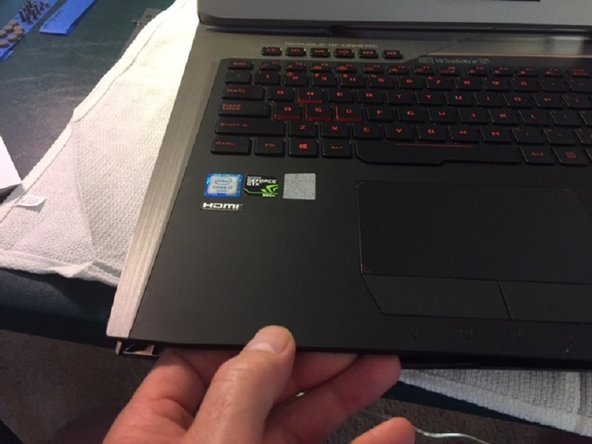

  6. Asus ROG Laptop G752VL-DH71 RAM under keyboard Replacement, Back panel removal part 5, prying front: crwdns2935265:06crwdnd2935265:01crwdnd2935265:03crwdne2935265:0 Asus ROG Laptop G752VL-DH71 RAM under keyboard Replacement, Back panel removal part 5, prying front: crwdns2935265:06crwdnd2935265:02crwdnd2935265:03crwdne2935265:0 Asus ROG Laptop G752VL-DH71 RAM under keyboard Replacement, Back panel removal part 5, prying front: crwdns2935265:06crwdnd2935265:03crwdnd2935265:03crwdne2935265:0
    • Start by using plastic tool by prying open the front center.
    • Stand it up if needed.
    • Work your way to the ends.

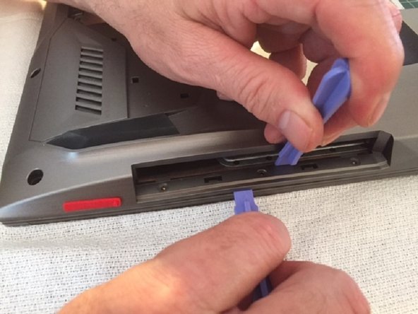

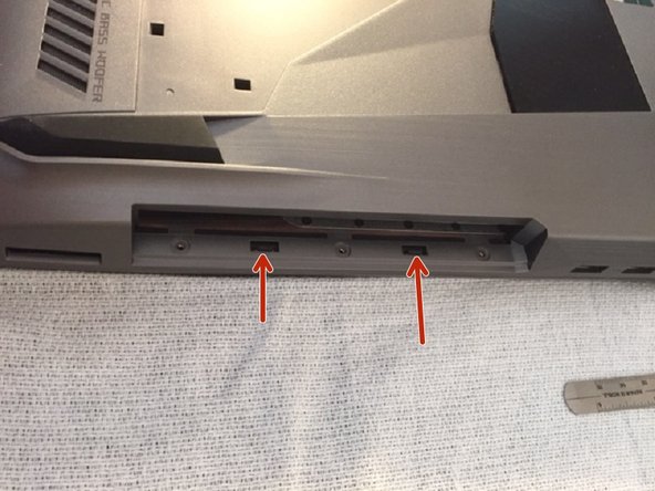

  7. Asus ROG Laptop G752VL-DH71 RAM under keyboard Replacement, Back panel removal part 6, side prying: crwdns2935265:07crwdnd2935265:01crwdnd2935265:03crwdne2935265:0 Asus ROG Laptop G752VL-DH71 RAM under keyboard Replacement, Back panel removal part 6, side prying: crwdns2935265:07crwdnd2935265:02crwdnd2935265:03crwdne2935265:0 Asus ROG Laptop G752VL-DH71 RAM under keyboard Replacement, Back panel removal part 6, side prying: crwdns2935265:07crwdnd2935265:03crwdnd2935265:03crwdne2935265:0
    • Start by prying the opposite side of the optical drive.
    • There are 2 small tabs that are locked where you pulled the optical drive out, you must unlock them.
    • Unlocking the 2 tabs using two plastic tools. Then continue prying open side.

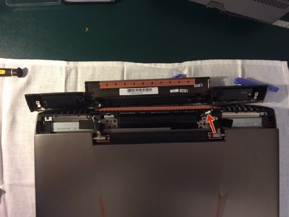

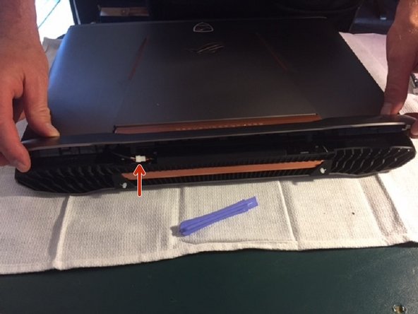

  8. Asus ROG Laptop G752VL-DH71 RAM under keyboard Replacement, Hinge cover removal: crwdns2935265:08crwdnd2935265:01crwdnd2935265:03crwdne2935265:0 Asus ROG Laptop G752VL-DH71 RAM under keyboard Replacement, Hinge cover removal: crwdns2935265:08crwdnd2935265:02crwdnd2935265:03crwdne2935265:0 Asus ROG Laptop G752VL-DH71 RAM under keyboard Replacement, Hinge cover removal: crwdns2935265:08crwdnd2935265:03crwdnd2935265:03crwdne2935265:0
    • Pry open the hinge cover with plastic tool. Careful there is a speaker wire attached so open carefully.
    • Disconnect speaker wire.

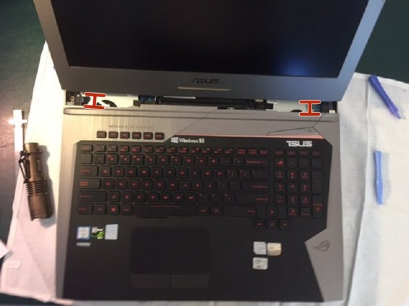

  9. Asus ROG Laptop G752VL-DH71 RAM under keyboard Replacement, Keyboard removal: crwdns2935265:09crwdnd2935265:01crwdnd2935265:03crwdne2935265:0 Asus ROG Laptop G752VL-DH71 RAM under keyboard Replacement, Keyboard removal: crwdns2935265:09crwdnd2935265:02crwdnd2935265:03crwdne2935265:0 Asus ROG Laptop G752VL-DH71 RAM under keyboard Replacement, Keyboard removal: crwdns2935265:09crwdnd2935265:03crwdnd2935265:03crwdne2935265:0
    • Once hinge cover is removed and back panel has been pried then turn laptop over and open monitor to extend past 90*.
    • Lift up a little and pull keyboard out about an inch but no more because there are ribbon cables attached underneath .

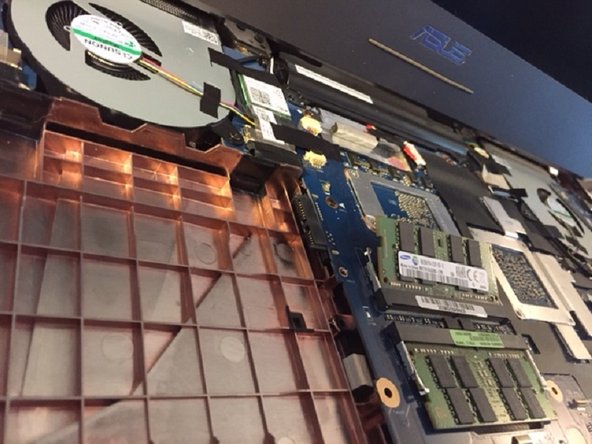

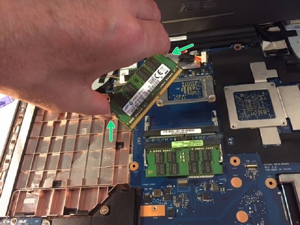

  12. Asus ROG Laptop G752VL-DH71 RAM under keyboard Replacement, RAM removal: crwdns2935265:012crwdnd2935265:01crwdnd2935265:03crwdne2935265:0 Asus ROG Laptop G752VL-DH71 RAM under keyboard Replacement, RAM removal: crwdns2935265:012crwdnd2935265:02crwdnd2935265:03crwdne2935265:0 Asus ROG Laptop G752VL-DH71 RAM under keyboard Replacement, RAM removal: crwdns2935265:012crwdnd2935265:03crwdnd2935265:03crwdne2935265:0
    • Notice to tabs on each side of RAM, pry them to the side.
    • When both tabs are pried to the side the RAM should pop up.
    • By grabbing the RAM on the sides, remove RAM.

Thanks for this guide! I purchased some RAM and an SSD and wanted to upgrade my laptop. The instructions were clear, and I was able to follow along to max out my laptop’s RAM at 64GB. All I needed was a size #0 phillips head, and a couple of spudgers.
