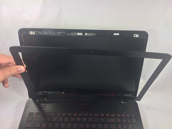

    • Use a plastic opening tool to pop out the bezel from all four sides, then lift it out of the frame.
    • When doing this in reverse during reassembly, try closing the laptop and applying pressure to reattach the bezel snaps.

Hey, I am having issues putting the plastic hinge caps back on after I'm done. I know there is a right one and a left one but I just don't know how to pop them back into place. Starting to get a bit desperate. Could anyone give me some tips?
Thanks!
