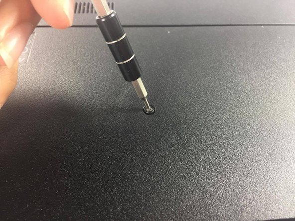

  4. Asus ROG GL551J Optical Drive Replacement, Optical Drive: crwdns2935265:04crwdnd2935265:01crwdnd2935265:02crwdne2935265:0 Asus ROG GL551J Optical Drive Replacement, Optical Drive: crwdns2935265:04crwdnd2935265:02crwdnd2935265:02crwdne2935265:0
    • Locate and unscrew the screw which connects the optical drive to the chassis
  5. Asus ROG GL551J Optical Drive Replacement: crwdns2935265:05crwdnd2935265:01crwdnd2935265:01crwdne2935265:0
    • Grasp the edge of the optical drive
  6. Asus ROG GL551J Optical Drive Replacement: crwdns2935265:06crwdnd2935265:01crwdnd2935265:01crwdne2935265:0
    • Pull on the optical drive gently. With little resistance, the optical drive should just slide out
