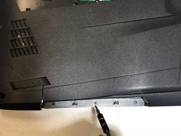

    • Lift up the rubber tab located in the upper-right corner of the backing plate.
  2. Asus ROG G751JT-DH72 RAM Replacement: crwdns2935265:02crwdnd2935265:01crwdnd2935265:01crwdne2935265:0
    • Use a Phillips #1 screwdriver to remove the 5.2 mm screw behind the rubber tap.
  3. Asus ROG G751JT-DH72 RAM Replacement: crwdns2935265:03crwdnd2935265:01crwdnd2935265:01crwdne2935265:0
    • Carefully pull the backing plate off. If you have a pry tool, you can pry on the edges carefully.
  4. Asus ROG G751JT-DH72 RAM Replacement: crwdns2935265:04crwdnd2935265:01crwdnd2935265:01crwdne2935265:0
    • Use a Phillips #1 screwdriver to remove the 5mm screw on the right side.

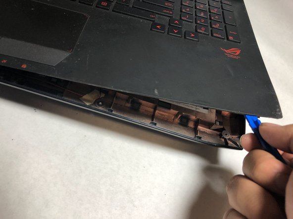

  10. Asus ROG G751JT-DH72 RAM Replacement: crwdns2935265:010crwdnd2935265:01crwdnd2935265:02crwdne2935265:0 Asus ROG G751JT-DH72 RAM Replacement: crwdns2935265:010crwdnd2935265:02crwdnd2935265:02crwdne2935265:0
    • Pry along the edges of the keyboard to lift it up.
    • Be careful not to damage the ribbon connectors.
