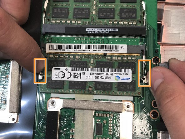

  12. Asus ROG G751JL-DS71 RAM Replacement, RAM: crwdns2935265:012crwdnd2935265:01crwdnd2935265:02crwdne2935265:0 Asus ROG G751JL-DS71 RAM Replacement, RAM: crwdns2935265:012crwdnd2935265:02crwdnd2935265:02crwdne2935265:0
    • First locate the RAM.
    • Then pull the tabs located on the left and right of the RAM outwards to release the RAM.
    • You can now remove the RAM and replace it.
