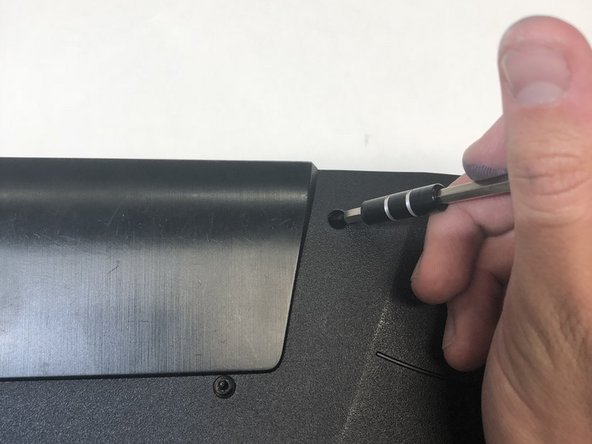

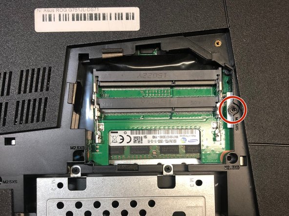

    • Lift the rubber cover found on the bottom of the laptop.
    • Remove the 5.2 mm screw with a Phillips 1 Screwdriver.

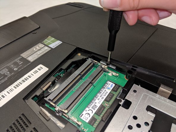

  3. Asus ROG G751JL-DS71 Left and Right Track Pad Buttons Replacement: crwdns2935265:03crwdnd2935265:01crwdnd2935265:03crwdne2935265:0 Asus ROG G751JL-DS71 Left and Right Track Pad Buttons Replacement: crwdns2935265:03crwdnd2935265:02crwdnd2935265:03crwdne2935265:0 Asus ROG G751JL-DS71 Left and Right Track Pad Buttons Replacement: crwdns2935265:03crwdnd2935265:03crwdnd2935265:03crwdne2935265:0
    • Use a Phillips 1 Screwdriver to remove the 5 mm screw that is located underneath the back panel.

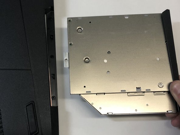

  4. Asus ROG G751JL-DS71 Left and Right Track Pad Buttons Replacement: crwdns2935265:04crwdnd2935265:01crwdnd2935265:02crwdne2935265:0 Asus ROG G751JL-DS71 Left and Right Track Pad Buttons Replacement: crwdns2935265:04crwdnd2935265:02crwdnd2935265:02crwdne2935265:0
    • Pull out the optical drive found on the side of the laptop.

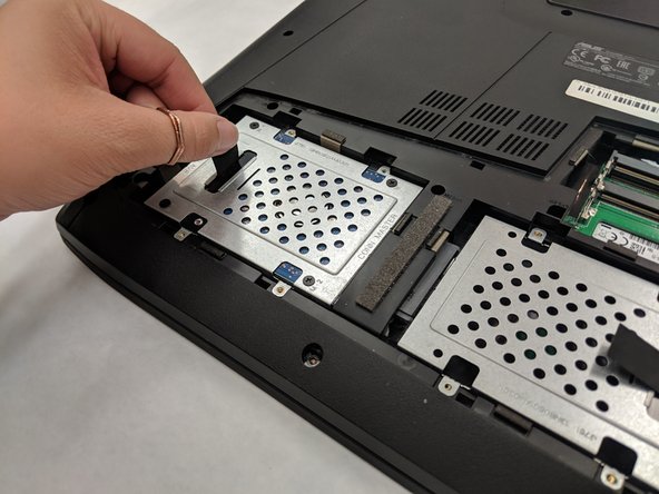

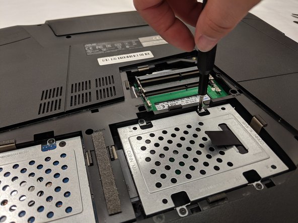

  5. Asus ROG G751JL-DS71 Left and Right Track Pad Buttons Replacement: crwdns2935265:05crwdnd2935265:01crwdnd2935265:03crwdne2935265:0 Asus ROG G751JL-DS71 Left and Right Track Pad Buttons Replacement: crwdns2935265:05crwdnd2935265:02crwdnd2935265:03crwdne2935265:0 Asus ROG G751JL-DS71 Left and Right Track Pad Buttons Replacement: crwdns2935265:05crwdnd2935265:03crwdnd2935265:03crwdne2935265:0
    • Remove the screws holding the hard drives in place using a Phillips 1 screwdriver.
    • Using the small flaps, remove the hard drives by hand.

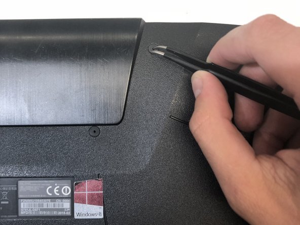

  6. Asus ROG G751JL-DS71 Left and Right Track Pad Buttons Replacement: crwdns2935265:06crwdnd2935265:01crwdnd2935265:02crwdne2935265:0 Asus ROG G751JL-DS71 Left and Right Track Pad Buttons Replacement: crwdns2935265:06crwdnd2935265:02crwdnd2935265:02crwdne2935265:0
    • Use a pair of tweezers to remove the top four rubber stoppers found on the bottom of the laptop.

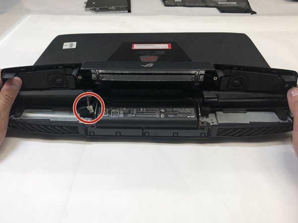

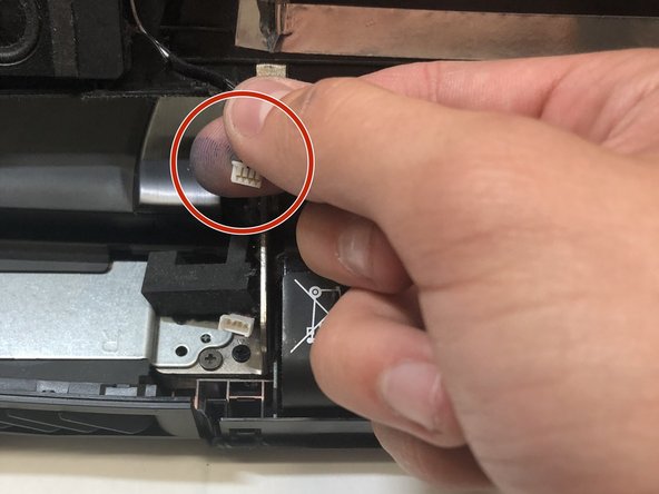

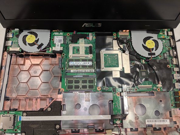

  8. Asus ROG G751JL-DS71 Left and Right Track Pad Buttons Replacement: crwdns2935265:08crwdnd2935265:01crwdnd2935265:03crwdne2935265:0 Asus ROG G751JL-DS71 Left and Right Track Pad Buttons Replacement: crwdns2935265:08crwdnd2935265:02crwdnd2935265:03crwdne2935265:0 Asus ROG G751JL-DS71 Left and Right Track Pad Buttons Replacement: crwdns2935265:08crwdnd2935265:03crwdnd2935265:03crwdne2935265:0
    • Use a metal spudger to carefully pry the top back panel off.
    • While removing the top back panel, be careful not to break the four pin connector located underneath.
    • Disconnect the four-pin connector and remove the top back panel from the computer.

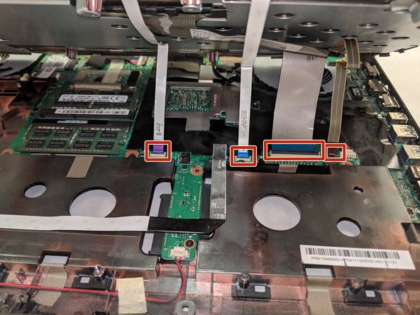

  12. Asus ROG G751JL-DS71 Left and Right Track Pad Buttons Replacement: crwdns2935265:012crwdnd2935265:01crwdnd2935265:02crwdne2935265:0 Asus ROG G751JL-DS71 Left and Right Track Pad Buttons Replacement: crwdns2935265:012crwdnd2935265:02crwdnd2935265:02crwdne2935265:0
    • Use a pair of tweezers to undo each of the four ribbon connectors.
    • The keyboard is now completely disconnected from the laptop and you can remove it.

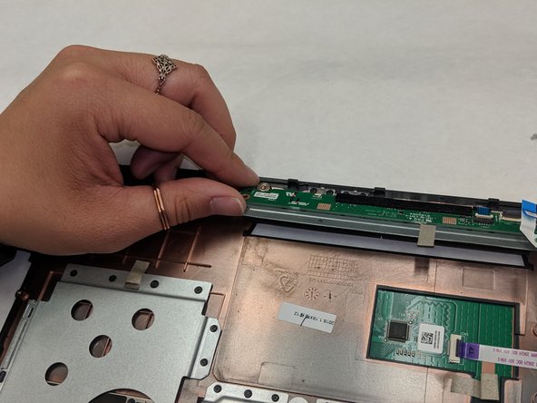

  13. Asus ROG G751JL-DS71 Left and Right Track Pad Buttons Replacement: crwdns2935265:013crwdnd2935265:01crwdnd2935265:02crwdne2935265:0 Asus ROG G751JL-DS71 Left and Right Track Pad Buttons Replacement: crwdns2935265:013crwdnd2935265:02crwdnd2935265:02crwdne2935265:0
    • Use a pair of tweezers to undo each of the two ribbon connectors.
    • Use a Phillips 1 Screwdriver to remove the four 6.8 mm screws underneath the back panel.
    • The Left and right button is now completely disconnected from the laptop and you can remove it.
