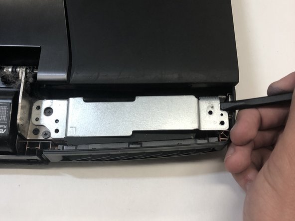

  7. Asus ROG G751JL-DS71 Keyboard Replacement: crwdns2935265:07crwdnd2935265:01crwdnd2935265:03crwdne2935265:0 Asus ROG G751JL-DS71 Keyboard Replacement: crwdns2935265:07crwdnd2935265:02crwdnd2935265:03crwdne2935265:0 Asus ROG G751JL-DS71 Keyboard Replacement: crwdns2935265:07crwdnd2935265:03crwdnd2935265:03crwdne2935265:0
    • Use a nylon spudger to carefully pry the top back panel off.
    • While removing the top back panel, be careful not to break the four pin connector located underneath.
    • Disconnect the four-pin connector and remove the top back panel from the computer.

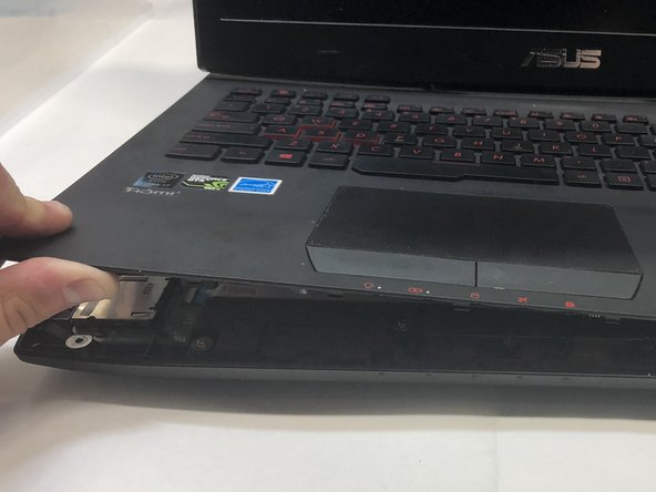

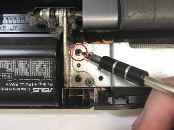

  8. Asus ROG G751JL-DS71 Keyboard Replacement, Keyboard: crwdns2935265:08crwdnd2935265:01crwdnd2935265:03crwdne2935265:0 Asus ROG G751JL-DS71 Keyboard Replacement, Keyboard: crwdns2935265:08crwdnd2935265:02crwdnd2935265:03crwdne2935265:0 Asus ROG G751JL-DS71 Keyboard Replacement, Keyboard: crwdns2935265:08crwdnd2935265:03crwdnd2935265:03crwdne2935265:0
    • Use a Phillips 1 Screwdriver to remove the four 6.8 mm screws underneath the back panel.
    • Lift away the metal housings from each side of the laptop.

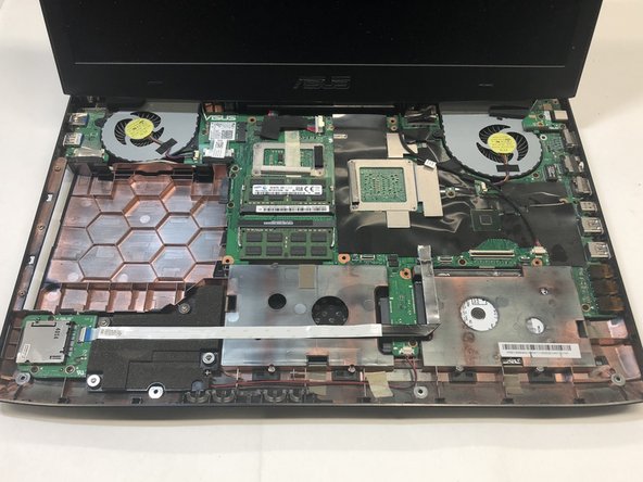

  9. Asus ROG G751JL-DS71 Keyboard Replacement: crwdns2935265:09crwdnd2935265:01crwdnd2935265:02crwdne2935265:0 Asus ROG G751JL-DS71 Keyboard Replacement: crwdns2935265:09crwdnd2935265:02crwdnd2935265:02crwdne2935265:0
    • Use a Phillips 1 Screwdriver to remove the ten 5.2 mm screws holding the main panel in place.
    • Use a Phillips 1 Screwdriver to remove the four 5.2 mm screws underneath the center panel.

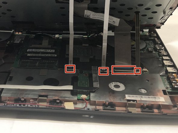

  10. Asus ROG G751JL-DS71 Keyboard Replacement: crwdns2935265:010crwdnd2935265:01crwdnd2935265:03crwdne2935265:0 Asus ROG G751JL-DS71 Keyboard Replacement: crwdns2935265:010crwdnd2935265:02crwdnd2935265:03crwdne2935265:0 Asus ROG G751JL-DS71 Keyboard Replacement: crwdns2935265:010crwdnd2935265:03crwdnd2935265:03crwdne2935265:0
    • Use a plastic opening tool to pry the keyboard from the base of the laptop.
    • Lift the keyboard carefully so as to not tear or break the four ribbon connectors underneath the keyboard.
  11. Asus ROG G751JL-DS71 Keyboard Replacement: crwdns2935265:011crwdnd2935265:01crwdnd2935265:02crwdne2935265:0 Asus ROG G751JL-DS71 Keyboard Replacement: crwdns2935265:011crwdnd2935265:02crwdnd2935265:02crwdne2935265:0
    • Use a pair of tweezers to undo each of the four ribbon connectors.
    • The keyboard is now completely disconnected from the laptop and you can remove it.
