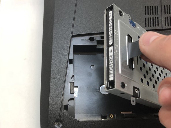

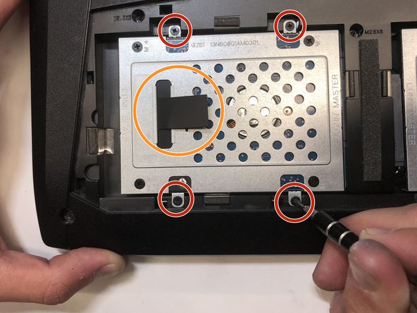

    • Use a Phillips 1 Screwdriver to remove the four 2.4 mm screws securing the hard drive.
    • Use the black pull-tab located on the shell covering the hard drive, to lift the hard drive housing and pull the hard drive away from the connector.
    • To access the hard drive on the right side of the laptop, perform the same steps, but on hard drive casing to the right of the previous hard drive.
