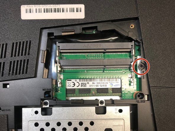

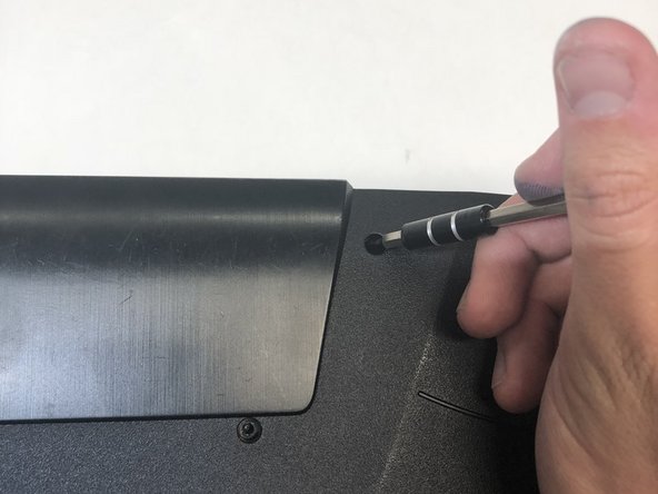

    • Lift the rubber cover found on the bottom of the laptop.
    • Remove the 5.2 mm screw with a Phillips 1 Screwdriver

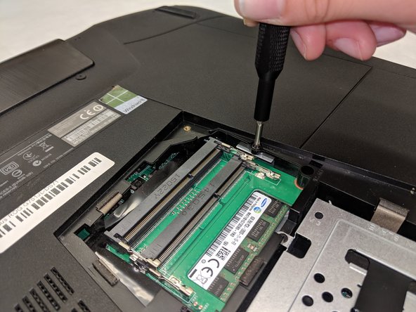

  3. Asus ROG G751JL-DS71 Central Processing Unit Replacement: crwdns2935265:03crwdnd2935265:01crwdnd2935265:03crwdne2935265:0 Asus ROG G751JL-DS71 Central Processing Unit Replacement: crwdns2935265:03crwdnd2935265:02crwdnd2935265:03crwdne2935265:0 Asus ROG G751JL-DS71 Central Processing Unit Replacement: crwdns2935265:03crwdnd2935265:03crwdnd2935265:03crwdne2935265:0
    • Use a Phillips 1 Screwdriver to remove the 5 mm screw that is located underneath the back panel.

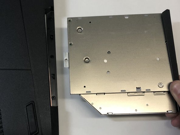

  4. Asus ROG G751JL-DS71 Central Processing Unit Replacement: crwdns2935265:04crwdnd2935265:01crwdnd2935265:02crwdne2935265:0 Asus ROG G751JL-DS71 Central Processing Unit Replacement: crwdns2935265:04crwdnd2935265:02crwdnd2935265:02crwdne2935265:0
    • Pull out the optical drive found on the side of the laptop.

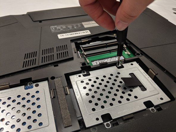

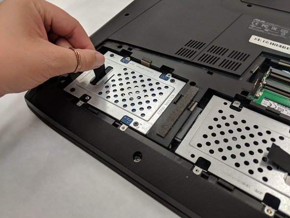

  5. Asus ROG G751JL-DS71 Central Processing Unit Replacement: crwdns2935265:05crwdnd2935265:01crwdnd2935265:03crwdne2935265:0 Asus ROG G751JL-DS71 Central Processing Unit Replacement: crwdns2935265:05crwdnd2935265:02crwdnd2935265:03crwdne2935265:0 Asus ROG G751JL-DS71 Central Processing Unit Replacement: crwdns2935265:05crwdnd2935265:03crwdnd2935265:03crwdne2935265:0
    • Remove the screws holding the hard drives in place using a phillips #1 screwdriver.
    • Using the small flaps, remove the hard drives by hand.

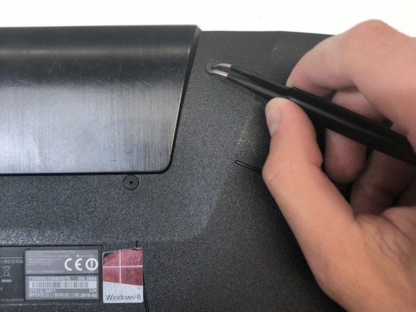

    • Use a pair of tweezers to remove the top four rubber stoppers found on the bottom of the laptop.

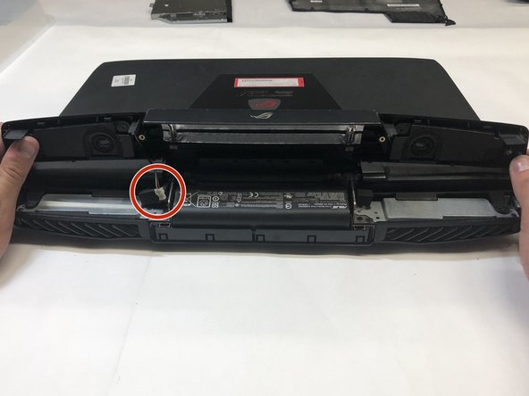

  8. Asus ROG G751JL-DS71 Central Processing Unit Replacement: crwdns2935265:08crwdnd2935265:01crwdnd2935265:03crwdne2935265:0 Asus ROG G751JL-DS71 Central Processing Unit Replacement: crwdns2935265:08crwdnd2935265:02crwdnd2935265:03crwdne2935265:0 Asus ROG G751JL-DS71 Central Processing Unit Replacement: crwdns2935265:08crwdnd2935265:03crwdnd2935265:03crwdne2935265:0

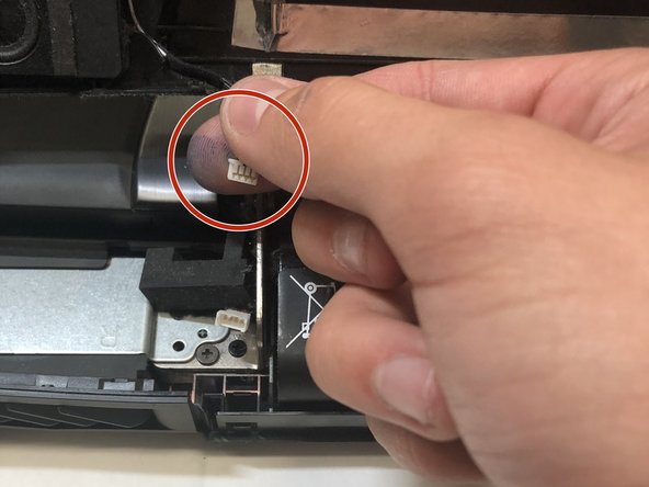

    • Use a metal spudger to carefully pry the top back panel off.
    • While removing the top back panel, be careful not to break the four pin connector located underneath.
    • Disconnect the four-pin connector and remove the top back panel from the computer.

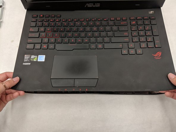

  11. Asus ROG G751JL-DS71 Central Processing Unit Replacement: crwdns2935265:011crwdnd2935265:01crwdnd2935265:03crwdne2935265:0 Asus ROG G751JL-DS71 Central Processing Unit Replacement: crwdns2935265:011crwdnd2935265:02crwdnd2935265:03crwdne2935265:0 Asus ROG G751JL-DS71 Central Processing Unit Replacement: crwdns2935265:011crwdnd2935265:03crwdnd2935265:03crwdne2935265:0
    • Use a metal opening tool to pry the keyboard from the base of the laptop.
    • Lift the keyboard carefully so as to not tear or break the four ribbon connectors underneath the keyboard.

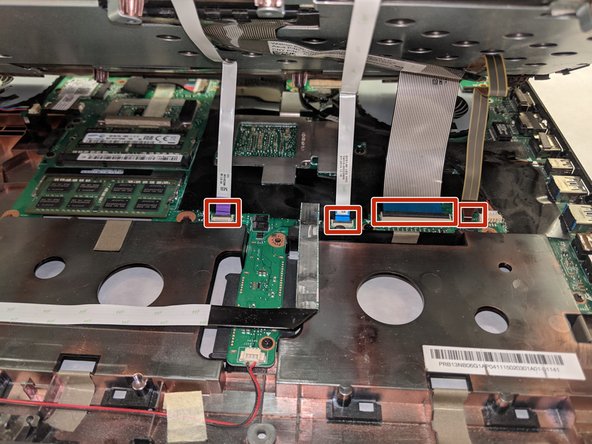

  12. Asus ROG G751JL-DS71 Central Processing Unit Replacement: crwdns2935265:012crwdnd2935265:01crwdnd2935265:02crwdne2935265:0 Asus ROG G751JL-DS71 Central Processing Unit Replacement: crwdns2935265:012crwdnd2935265:02crwdnd2935265:02crwdne2935265:0
    • Use a pair of tweezers to undo each of the four ribbon connectors.
    • The keyboard is now completely disconnected from the laptop and you can remove it.

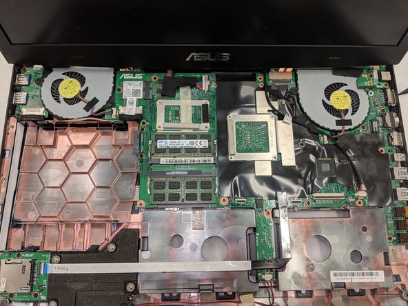

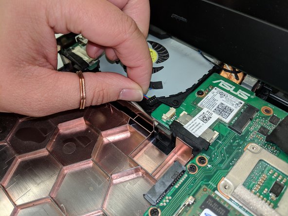

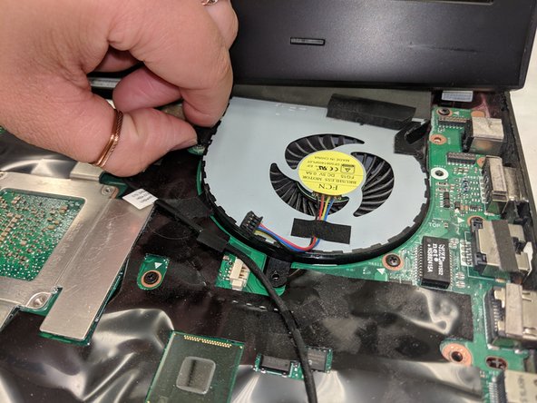

  13. Asus ROG G751JL-DS71 Central Processing Unit Replacement: crwdns2935265:013crwdnd2935265:01crwdnd2935265:03crwdne2935265:0 Asus ROG G751JL-DS71 Central Processing Unit Replacement: crwdns2935265:013crwdnd2935265:02crwdnd2935265:03crwdne2935265:0 Asus ROG G751JL-DS71 Central Processing Unit Replacement: crwdns2935265:013crwdnd2935265:03crwdnd2935265:03crwdne2935265:0
    • Remove the ribbon that connect the fans.

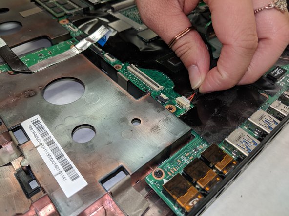

  14. Asus ROG G751JL-DS71 Central Processing Unit Replacement: crwdns2935265:014crwdnd2935265:01crwdnd2935265:02crwdne2935265:0 Asus ROG G751JL-DS71 Central Processing Unit Replacement: crwdns2935265:014crwdnd2935265:02crwdnd2935265:02crwdne2935265:0
    • Remove the ribbon cables connected to the motherboard.

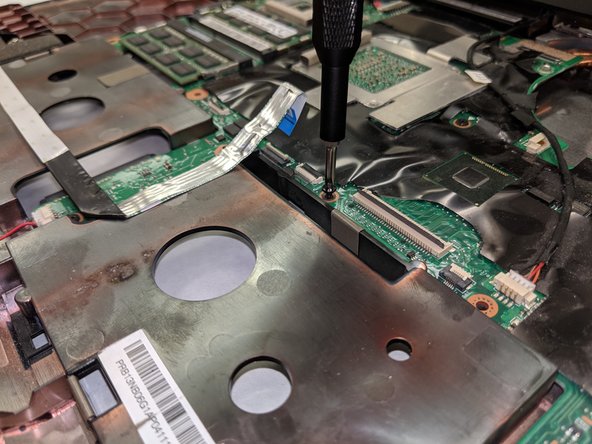

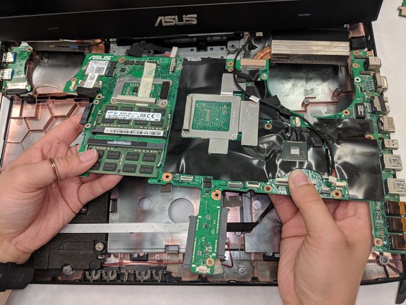

  15. Asus ROG G751JL-DS71 Central Processing Unit Replacement: crwdns2935265:015crwdnd2935265:01crwdnd2935265:03crwdne2935265:0 Asus ROG G751JL-DS71 Central Processing Unit Replacement: crwdns2935265:015crwdnd2935265:02crwdnd2935265:03crwdne2935265:0 Asus ROG G751JL-DS71 Central Processing Unit Replacement: crwdns2935265:015crwdnd2935265:03crwdnd2935265:03crwdne2935265:0
    • Remove the screws holding in the motherboard using a Phillips 0 screwdriver.
    • Remove the motherboard by hand. Be careful as the radiators for the fans are connected underneath the screen.

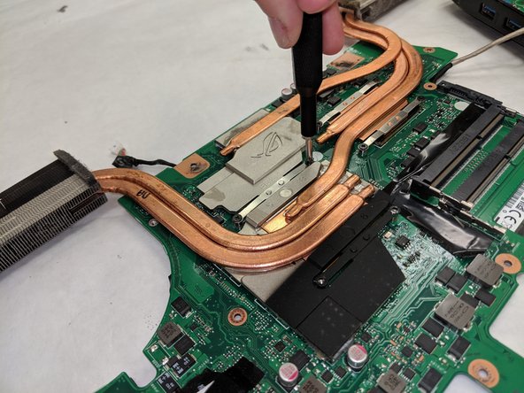

  16. Asus ROG G751JL-DS71 Central Processing Unit Replacement: crwdns2935265:016crwdnd2935265:01crwdnd2935265:03crwdne2935265:0 Asus ROG G751JL-DS71 Central Processing Unit Replacement: crwdns2935265:016crwdnd2935265:02crwdnd2935265:03crwdne2935265:0 Asus ROG G751JL-DS71 Central Processing Unit Replacement: crwdns2935265:016crwdnd2935265:03crwdnd2935265:03crwdne2935265:0
    • Remove the heat sink by hand. Be careful not to get thermal paste on your hand

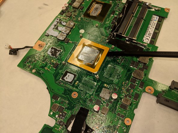

  17. Asus ROG G751JL-DS71 Central Processing Unit Replacement: crwdns2935265:017crwdnd2935265:01crwdnd2935265:02crwdne2935265:0 Asus ROG G751JL-DS71 Central Processing Unit Replacement: crwdns2935265:017crwdnd2935265:02crwdnd2935265:02crwdne2935265:0
    • The CPU can then be removed with a regular spudger.
    • The CPU is now completely disconnected from the laptop and you can remove it.

I was following this guide normally but then I saw the last step... are you f***ing kidding me?! You DO NOT PRY OFF that chip!! It's a BGA connection and you WILL destroy it. If you need your CPU or GPU replaced, either buy a new motherboard or seek a professional's service that replaces chips like that. But yikes, an iFixit guide that's pretty coherent yet the last step implies removing the chip and damaging it... I must be hallucinating. If anyone did mindlessly follow this guide without prior experience... you have my deepest condolences.
