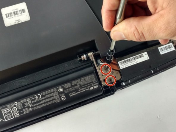

  14. Asus ROG G751JL-DS71 Battery Replacement, Battery: crwdns2935265:014crwdnd2935265:01crwdnd2935265:02crwdne2935265:0 Asus ROG G751JL-DS71 Battery Replacement, Battery: crwdns2935265:014crwdnd2935265:02crwdnd2935265:02crwdne2935265:0
    • Disconnect the pin connector that attaches the battery to the motherboard.
    • Use a Phillips 1 Screwdriver to remove the two 5.4 mm screws.
  15. Asus ROG G751JL-DS71 Battery Replacement: crwdns2935265:015crwdnd2935265:01crwdnd2935265:02crwdne2935265:0 Asus ROG G751JL-DS71 Battery Replacement: crwdns2935265:015crwdnd2935265:02crwdnd2935265:02crwdne2935265:0
    • The battery can now be lifted away from the laptop.

I have a G751JT-CH71 & I'm not sure if the models are slightly different but I cannot remove the battery by simply lifting it out of the compartment. The battery has 4 lock-in tabs towards the back of the laptop AND 2 additional tabs that are beneath the board. I'm going to carefully pry the battery out, but I'm unsure if there's a recommended method to prying the battery out…
