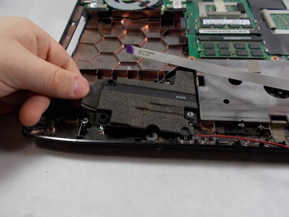

  9. Asus ROG G751JL-BSI7T28 Speaker Replacement, Speaker: crwdns2935265:09crwdnd2935265:01crwdnd2935265:02crwdne2935265:0 Asus ROG G751JL-BSI7T28 Speaker Replacement, Speaker: crwdns2935265:09crwdnd2935265:02crwdnd2935265:02crwdne2935265:0

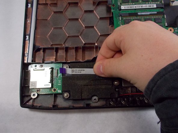

    • Flip the SD card reader's retaining arm up.
    • Remove the SD card reader's power/data ribbon cable.

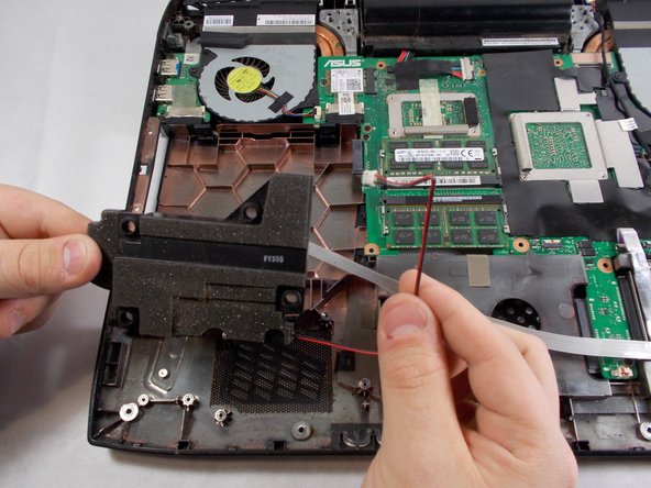

  10. Asus ROG G751JL-BSI7T28 Speaker Replacement: crwdns2935265:010crwdnd2935265:01crwdnd2935265:03crwdne2935265:0 Asus ROG G751JL-BSI7T28 Speaker Replacement: crwdns2935265:010crwdnd2935265:02crwdnd2935265:03crwdne2935265:0 Asus ROG G751JL-BSI7T28 Speaker Replacement: crwdns2935265:010crwdnd2935265:03crwdnd2935265:03crwdne2935265:0
    • Remove the speaker's power/data cable.
  11. Asus ROG G751JL-BSI7T28 Speaker Replacement: crwdns2935265:011crwdnd2935265:01crwdnd2935265:02crwdne2935265:0 Asus ROG G751JL-BSI7T28 Speaker Replacement: crwdns2935265:011crwdnd2935265:02crwdnd2935265:02crwdne2935265:0

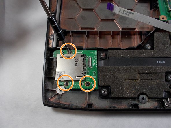

    • Remove four 3mm Phillips #0 screws from the speaker.
    • Remove three 3mm Phillips #0 screws from the SD card reader.

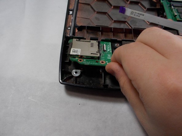

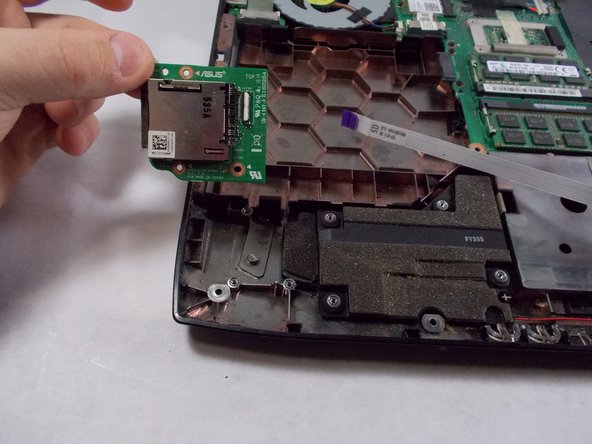

  12. Asus ROG G751JL-BSI7T28 Speaker Replacement: crwdns2935265:012crwdnd2935265:01crwdnd2935265:03crwdne2935265:0 Asus ROG G751JL-BSI7T28 Speaker Replacement: crwdns2935265:012crwdnd2935265:02crwdnd2935265:03crwdne2935265:0 Asus ROG G751JL-BSI7T28 Speaker Replacement: crwdns2935265:012crwdnd2935265:03crwdnd2935265:03crwdne2935265:0
    • Remove the SD card reader.
  13. Asus ROG G751JL-BSI7T28 Speaker Replacement: crwdns2935265:013crwdnd2935265:01crwdnd2935265:03crwdne2935265:0 Asus ROG G751JL-BSI7T28 Speaker Replacement: crwdns2935265:013crwdnd2935265:02crwdnd2935265:03crwdne2935265:0 Asus ROG G751JL-BSI7T28 Speaker Replacement: crwdns2935265:013crwdnd2935265:03crwdnd2935265:03crwdne2935265:0
    • Remove the speaker from the laptop.
