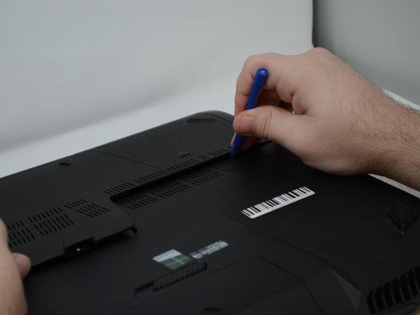

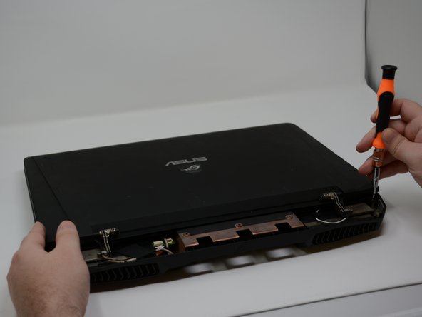

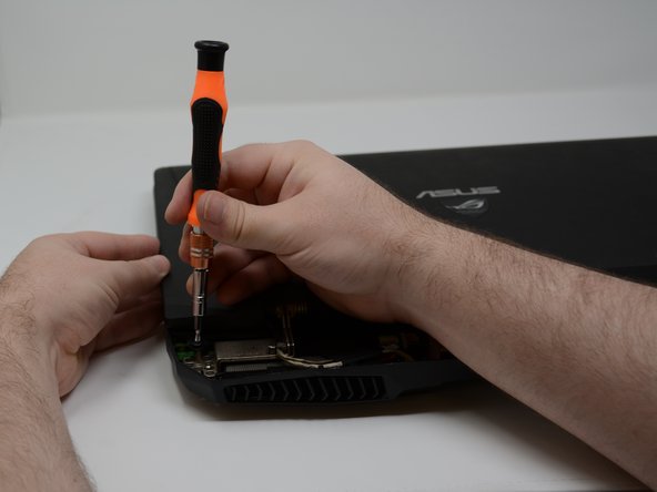

    • Using a plastic opening tool, remove the two rubber tabs circled in red.
  2. Asus ROG G750JM-BSI7N23 Motherboard Replacement: crwdns2935265:02crwdnd2935265:01crwdnd2935265:02crwdne2935265:0 Asus ROG G750JM-BSI7N23 Motherboard Replacement: crwdns2935265:02crwdnd2935265:02crwdnd2935265:02crwdne2935265:0
    • Remove both of the 8mm Phillips #2 screws from these slots where the rubber caps were removed.

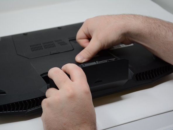

    • Slide the tab to pop the battery out of its holder.
    • Pull the battery out of its slot.

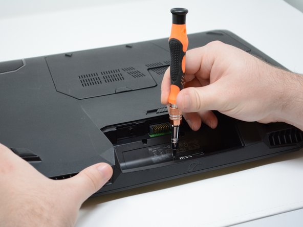

  4. Asus ROG G750JM-BSI7N23 Motherboard Replacement: crwdns2935265:04crwdnd2935265:01crwdnd2935265:02crwdne2935265:0 Asus ROG G750JM-BSI7N23 Motherboard Replacement: crwdns2935265:04crwdnd2935265:02crwdnd2935265:02crwdne2935265:0
    • Remove the three 4mm Phillips #2 screws from the open battery slot as shown.
    • Remove the two 5mm Phillips #2 screws.

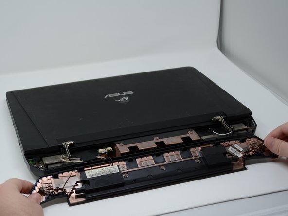

  5. Asus ROG G750JM-BSI7N23 Motherboard Replacement: crwdns2935265:05crwdnd2935265:01crwdnd2935265:03crwdne2935265:0 Asus ROG G750JM-BSI7N23 Motherboard Replacement: crwdns2935265:05crwdnd2935265:02crwdnd2935265:03crwdne2935265:0 Asus ROG G750JM-BSI7N23 Motherboard Replacement: crwdns2935265:05crwdnd2935265:03crwdnd2935265:03crwdne2935265:0
    • Begin prying up on the plate as shown in the pictures.
  6. Asus ROG G750JM-BSI7N23 Motherboard Replacement: crwdns2935265:06crwdnd2935265:01crwdnd2935265:01crwdne2935265:0
    • Detach the single connector using your plastic opening tool.
    • Remove the speaker bar.

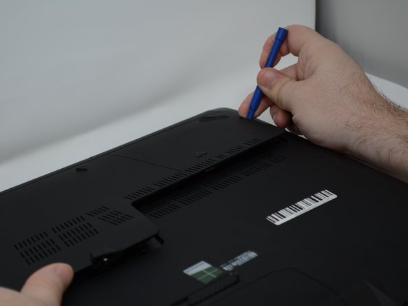

  7. Asus ROG G750JM-BSI7N23 Motherboard Replacement, Back Plate: crwdns2935265:07crwdnd2935265:01crwdnd2935265:01crwdne2935265:0
    • With the computer upside down, lift up on the rubber cap on the back plate to access the captive Phillips #2 screw.
  8. Asus ROG G750JM-BSI7N23 Motherboard Replacement: crwdns2935265:08crwdnd2935265:01crwdnd2935265:01crwdne2935265:0
    • Retract the Phillips #2 screw until the cover is loose.
    • The screw will not come all the way out.

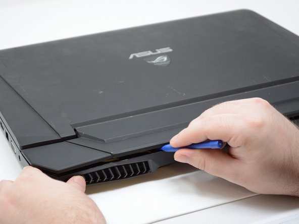

  9. Asus ROG G750JM-BSI7N23 Motherboard Replacement: crwdns2935265:09crwdnd2935265:01crwdnd2935265:03crwdne2935265:0 Asus ROG G750JM-BSI7N23 Motherboard Replacement: crwdns2935265:09crwdnd2935265:02crwdnd2935265:03crwdne2935265:0 Asus ROG G750JM-BSI7N23 Motherboard Replacement: crwdns2935265:09crwdnd2935265:03crwdnd2935265:03crwdne2935265:0
    • Pry around the edges of the plate using a plastic opening tool until the plate is removed.

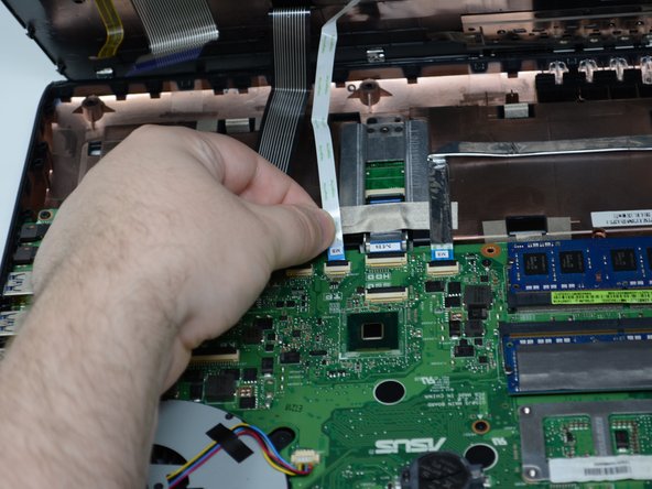

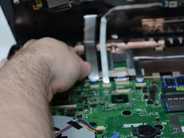

    • Remove the four connectors using your pry tool.
    • The keyboard will now be separated from the main computer.

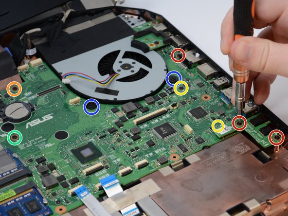

  14. Asus ROG G750JM-BSI7N23 Motherboard Replacement, Motherboard: crwdns2935265:014crwdnd2935265:01crwdnd2935265:03crwdne2935265:0 Asus ROG G750JM-BSI7N23 Motherboard Replacement, Motherboard: crwdns2935265:014crwdnd2935265:02crwdnd2935265:03crwdne2935265:0 Asus ROG G750JM-BSI7N23 Motherboard Replacement, Motherboard: crwdns2935265:014crwdnd2935265:03crwdnd2935265:03crwdne2935265:0
    • First, remove the two 7mm #2 Phillips screws circled in red to fold the silver plate over.
    • Remove all the connectors shown in the orange squares. You may need to use your plastic opening tool for the smaller ones.
  15. Asus ROG G750JM-BSI7N23 Motherboard Replacement: crwdns2935265:015crwdnd2935265:01crwdnd2935265:03crwdne2935265:0 Asus ROG G750JM-BSI7N23 Motherboard Replacement: crwdns2935265:015crwdnd2935265:02crwdnd2935265:03crwdne2935265:0 Asus ROG G750JM-BSI7N23 Motherboard Replacement: crwdns2935265:015crwdnd2935265:03crwdnd2935265:03crwdne2935265:0

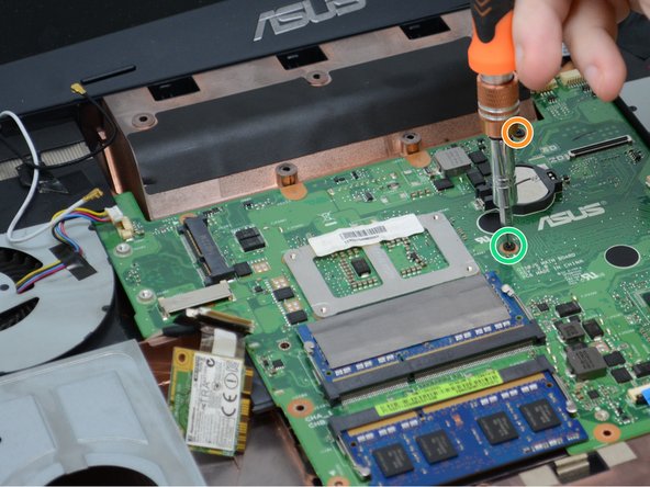

    • Remove the three #2 Phillips screws from the small wireless card located in the top left.
  16. Asus ROG G750JM-BSI7N23 Motherboard Replacement: crwdns2935265:016crwdnd2935265:01crwdnd2935265:02crwdne2935265:0 Asus ROG G750JM-BSI7N23 Motherboard Replacement: crwdns2935265:016crwdnd2935265:02crwdnd2935265:02crwdne2935265:0

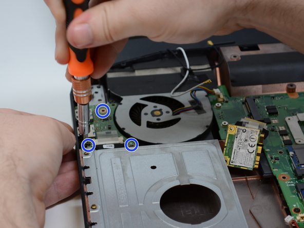

    • Remove the three #2 Phillips screws from the small power button card in the top right.

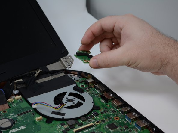

  17. Asus ROG G750JM-BSI7N23 Motherboard Replacement: crwdns2935265:017crwdnd2935265:01crwdnd2935265:01crwdne2935265:0
    • Remove the two #2 Phillips screws for the audio card located in the bottom right.
  18. Asus ROG G750JM-BSI7N23 Motherboard Replacement: crwdns2935265:018crwdnd2935265:01crwdnd2935265:03crwdne2935265:0 Asus ROG G750JM-BSI7N23 Motherboard Replacement: crwdns2935265:018crwdnd2935265:02crwdnd2935265:03crwdne2935265:0 Asus ROG G750JM-BSI7N23 Motherboard Replacement: crwdns2935265:018crwdnd2935265:03crwdnd2935265:03crwdne2935265:0
    • Remove all 8mm #2 Phillips screws .
    • Remove all 2mm #2 Phillips screws.
    • Remove all 3mm #2 Phillips screws.
    • Remove all 7mm #2 Phillips screws.
    • Remove all 4mm #2 Phillips screws.

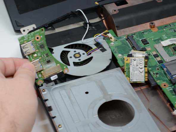

  19. Asus ROG G750JM-BSI7N23 Motherboard Replacement: crwdns2935265:019crwdnd2935265:01crwdnd2935265:01crwdne2935265:0
    • When all the screws are removed, pry up on the edges of the circuit board. You may need your plastic opening tool to access the edges.
