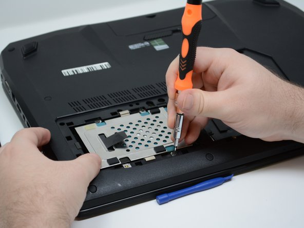

    • With the computer upside down, lift up on the rubber cap on the back plate to access the captive Phillips #2 screw.
  2. Asus ROG G750JM-BS17N23 Hard Drive Replacement: crwdns2935265:02crwdnd2935265:01crwdnd2935265:01crwdne2935265:0
    • Retract the Phillips #2 screw until the cover is loose.
    • The screw will not come all the way out.
  3. Asus ROG G750JM-BS17N23 Hard Drive Replacement: crwdns2935265:03crwdnd2935265:01crwdnd2935265:03crwdne2935265:0 Asus ROG G750JM-BS17N23 Hard Drive Replacement: crwdns2935265:03crwdnd2935265:02crwdnd2935265:03crwdne2935265:0 Asus ROG G750JM-BS17N23 Hard Drive Replacement: crwdns2935265:03crwdnd2935265:03crwdnd2935265:03crwdne2935265:0
    • Pry around the edges of the plate using a plastic opening tool until the plate is removed.
  4. Asus ROG G750JM-BS17N23 Hard Drive Replacement, Hard Drive: crwdns2935265:04crwdnd2935265:01crwdnd2935265:01crwdne2935265:0
    • To access the hard drive, remove the back plate.
  5. Asus ROG G750JM-BS17N23 Hard Drive Replacement: crwdns2935265:05crwdnd2935265:01crwdnd2935265:02crwdne2935265:0 Asus ROG G750JM-BS17N23 Hard Drive Replacement: crwdns2935265:05crwdnd2935265:02crwdnd2935265:02crwdne2935265:0

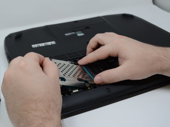

    • Remove the three 4mm Phillips #2 screws.
  6. Asus ROG G750JM-BS17N23 Hard Drive Replacement: crwdns2935265:06crwdnd2935265:01crwdnd2935265:02crwdne2935265:0 Asus ROG G750JM-BS17N23 Hard Drive Replacement: crwdns2935265:06crwdnd2935265:02crwdnd2935265:02crwdne2935265:0
    • Pull back on the tab on the hard drive shield until it is clear of the screw slots. Next pull the shield out.
  7. Asus ROG G750JM-BS17N23 Hard Drive Replacement: crwdns2935265:07crwdnd2935265:01crwdnd2935265:02crwdne2935265:0 Asus ROG G750JM-BS17N23 Hard Drive Replacement: crwdns2935265:07crwdnd2935265:02crwdnd2935265:02crwdne2935265:0

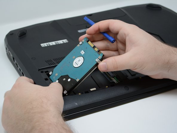

    • With the hard drive exposed, pull the hard drive away from the connection point and then remove the hard drive.
