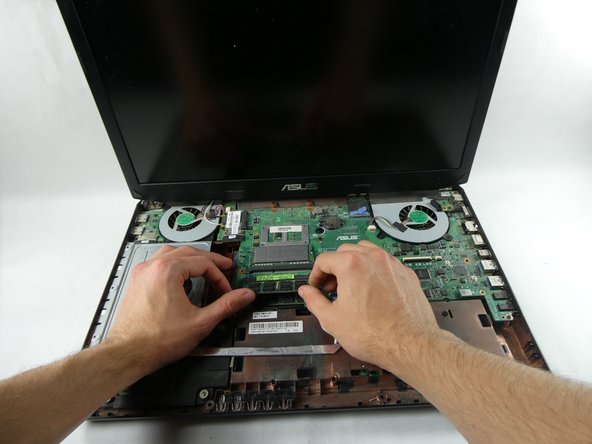

  10. Asus ROG G750JH-DB71 RAM Replacement, RAM: crwdns2935265:010crwdnd2935265:01crwdnd2935265:02crwdne2935265:0 Asus ROG G750JH-DB71 RAM Replacement, RAM: crwdns2935265:010crwdnd2935265:02crwdnd2935265:02crwdne2935265:0
    • The RAM module is located directly in the center of the computer on top of the motherboard.
    • Push in the two levers on each side of the RAM module. This frees the module from the slot and allows removal.
    • Once loose, pull the RAM module away from the slot at a 45 degree angle as to not damage it.
