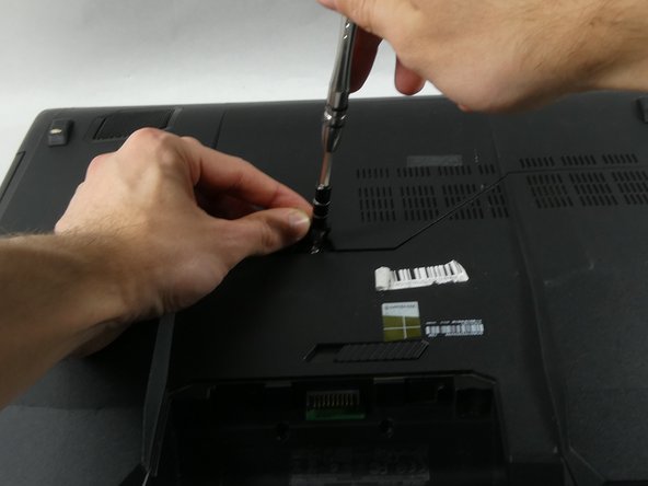

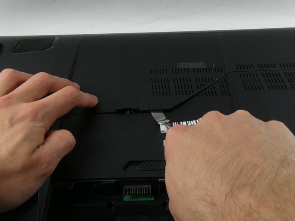

  3. Asus ROG G750JH-DB71 Hard Drive Replacement, Hard Drive: crwdns2935265:03crwdnd2935265:01crwdnd2935265:03crwdne2935265:0 Asus ROG G750JH-DB71 Hard Drive Replacement, Hard Drive: crwdns2935265:03crwdnd2935265:02crwdnd2935265:03crwdne2935265:0 Asus ROG G750JH-DB71 Hard Drive Replacement, Hard Drive: crwdns2935265:03crwdnd2935265:03crwdnd2935265:03crwdne2935265:0
    • Use a pick or your finger to lift up the plastic cover on back of the laptop.
    • Under the plastic cover is a screw, unscrew it using a Phillips #00 screwdriver.
    • The screw has a c lock so it can not be unscrewed completely. Once Its loose pry on the seam using a screwdriver or the iFixit pry tool.
  4. Asus ROG G750JH-DB71 Hard Drive Replacement: crwdns2935265:04crwdnd2935265:01crwdnd2935265:03crwdne2935265:0 Asus ROG G750JH-DB71 Hard Drive Replacement: crwdns2935265:04crwdnd2935265:02crwdnd2935265:03crwdne2935265:0 Asus ROG G750JH-DB71 Hard Drive Replacement: crwdns2935265:04crwdnd2935265:03crwdnd2935265:03crwdne2935265:0
    • Remove the cover.
    • Remove the four 4.0 mm Phillips #00 screws holding in the hard drive caddy.
    • Push the caddy towards the open space in its compartment to remove it.
