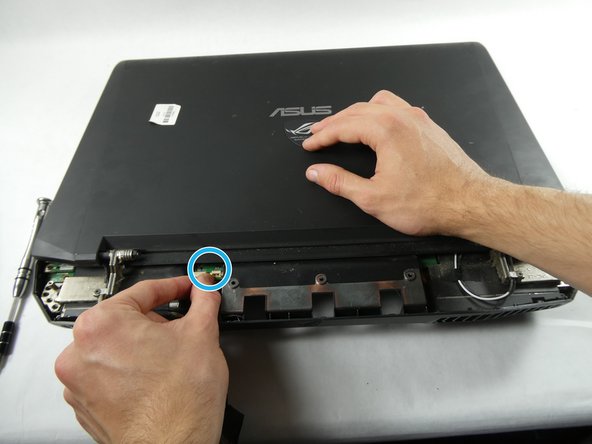

  10. Asus ROG G750JH-DB71 Graphics Card Replacement, Fan: crwdns2935265:010crwdnd2935265:01crwdnd2935265:01crwdne2935265:0
    • Remove the Data and Wi-fi cables from the sockets shown.
  11. Asus ROG G750JH-DB71 Graphics Card Replacement: crwdns2935265:011crwdnd2935265:01crwdnd2935265:03crwdne2935265:0 Asus ROG G750JH-DB71 Graphics Card Replacement: crwdns2935265:011crwdnd2935265:02crwdnd2935265:03crwdne2935265:0 Asus ROG G750JH-DB71 Graphics Card Replacement: crwdns2935265:011crwdnd2935265:03crwdnd2935265:03crwdne2935265:0

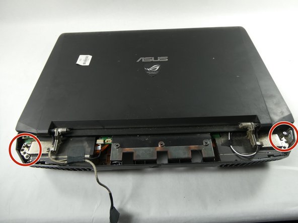

    • Slowly close the lid and turn the device around.
    • Remove the 6 screws (3 on each side) from the edges of the device. (8mm Phillips 00)
    • Remove the Webcam cable.
  12. Asus ROG G750JH-DB71 Graphics Card Replacement: crwdns2935265:012crwdnd2935265:01crwdnd2935265:03crwdne2935265:0 Asus ROG G750JH-DB71 Graphics Card Replacement: crwdns2935265:012crwdnd2935265:02crwdnd2935265:03crwdne2935265:0 Asus ROG G750JH-DB71 Graphics Card Replacement: crwdns2935265:012crwdnd2935265:03crwdnd2935265:03crwdne2935265:0
    • Carefully lift the lid away from the rest of the device.
    • There may be tape covering the fans or other components. Remove it slowly as to not damage anything.

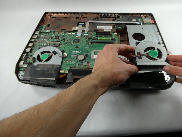

  13. Asus ROG G750JH-DB71 Graphics Card Replacement: crwdns2935265:013crwdnd2935265:01crwdnd2935265:03crwdne2935265:0 Asus ROG G750JH-DB71 Graphics Card Replacement: crwdns2935265:013crwdnd2935265:02crwdnd2935265:03crwdne2935265:0 Asus ROG G750JH-DB71 Graphics Card Replacement: crwdns2935265:013crwdnd2935265:03crwdnd2935265:03crwdne2935265:0
    • Remove the three screws surrounding each fan shown along with the ribbon cables connecting them to the motherboard. (4mm Phillips 00)
    • Remove the USB port board blocking the rightmost fan.
    • Remove the fans from the board.

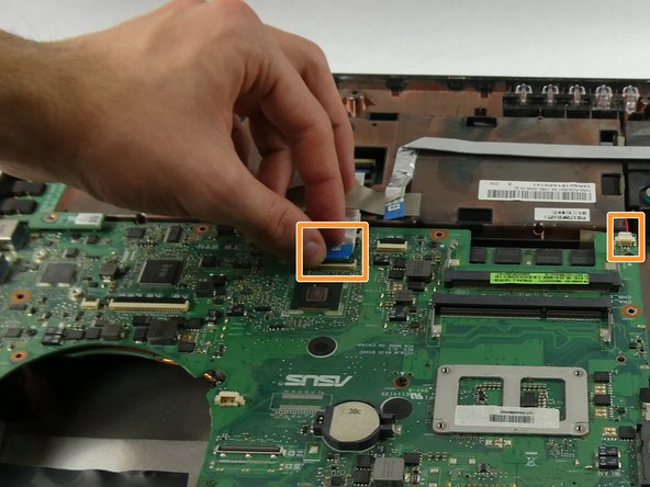

  14. Asus ROG G750JH-DB71 Graphics Card Replacement, Graphics Card: crwdns2935265:014crwdnd2935265:01crwdnd2935265:02crwdne2935265:0 Asus ROG G750JH-DB71 Graphics Card Replacement, Graphics Card: crwdns2935265:014crwdnd2935265:02crwdnd2935265:02crwdne2935265:0
    • Use a Phillips #00 to remove seven 4.0 mm screws connecting the motherboard to the case.
    • Disconnect the cables still attached to the main board.

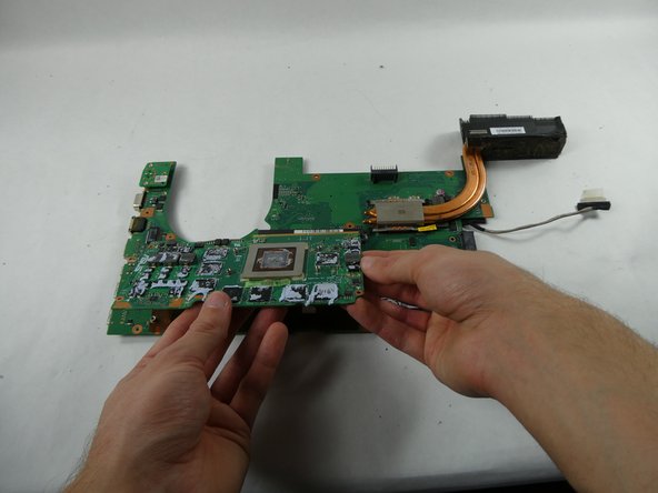

  15. Asus ROG G750JH-DB71 Graphics Card Replacement: crwdns2935265:015crwdnd2935265:01crwdnd2935265:02crwdne2935265:0 Asus ROG G750JH-DB71 Graphics Card Replacement: crwdns2935265:015crwdnd2935265:02crwdnd2935265:02crwdne2935265:0
    • Slowly lift the main board out of the chassis.

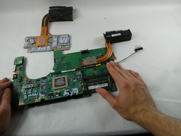

  16. Asus ROG G750JH-DB71 Graphics Card Replacement: crwdns2935265:016crwdnd2935265:01crwdnd2935265:03crwdne2935265:0 Asus ROG G750JH-DB71 Graphics Card Replacement: crwdns2935265:016crwdnd2935265:02crwdnd2935265:03crwdne2935265:0 Asus ROG G750JH-DB71 Graphics Card Replacement: crwdns2935265:016crwdnd2935265:03crwdnd2935265:03crwdne2935265:0
    • Use a Phillips #00 screwdriver to remove the four 4 mm screws connecting to the heat sink.
    • Use a Phillips #00 screwdriver to remove the three 1 mm screws connected to the board.
    • Lift the graphics card off to remove it from the main board.
