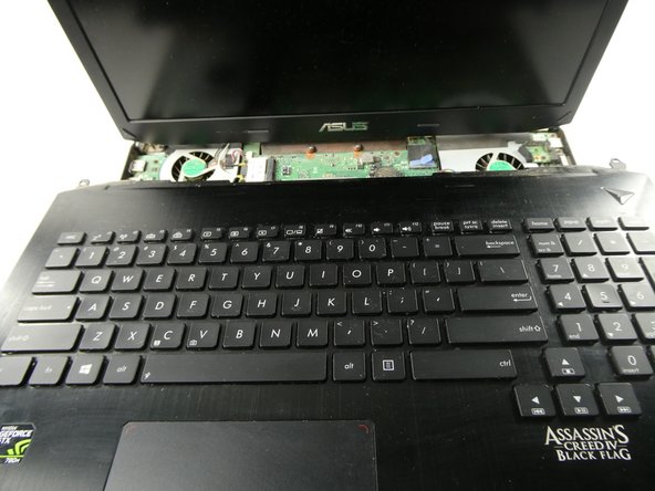

    • Pry the keyboard gently using a spudger.
    • Make sure to unhook the cables and wires from the keyboard gently in Picture 3.
  9. Asus ROG G750JH-DB71 Disassembly: crwdns2935265:09crwdnd2935265:01crwdnd2935265:02crwdne2935265:0 Asus ROG G750JH-DB71 Disassembly: crwdns2935265:09crwdnd2935265:02crwdnd2935265:02crwdne2935265:0
    • Now you can pull the keyboard off but make sure to do so carefully without damaging or scuffing any components.
    • Pull up and out at an angle to avoid damaging the internals of the laptop.
