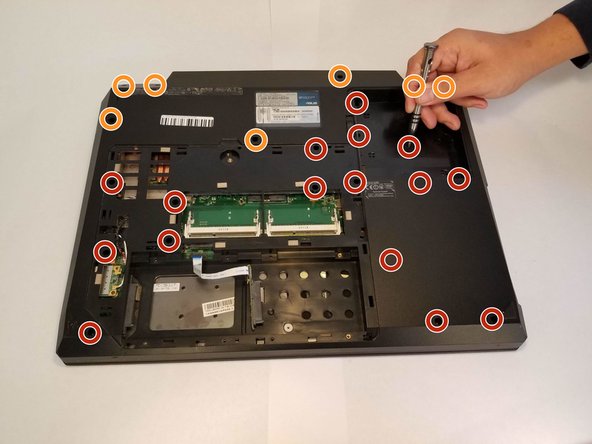

  4. Asus ROG G74SX-DH73-3D Track Pad Buttons Replacement: crwdns2935265:04crwdnd2935265:01crwdnd2935265:02crwdne2935265:0 Asus ROG G74SX-DH73-3D Track Pad Buttons Replacement: crwdns2935265:04crwdnd2935265:02crwdnd2935265:02crwdne2935265:0
    • Remove the battery to access the screws under it.
    • Remove these 16 screws with a regular Phillips head screw-driver.
    • These Phillips head screws will require a longer bit or an extension.

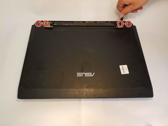

  5. Asus ROG G74SX-DH73-3D Track Pad Buttons Replacement: crwdns2935265:05crwdnd2935265:01crwdnd2935265:02crwdne2935265:0 Asus ROG G74SX-DH73-3D Track Pad Buttons Replacement: crwdns2935265:05crwdnd2935265:02crwdnd2935265:02crwdne2935265:0
    • Flip the device back over.
    • Pull off the plastic cover behind the screen.
    • Remove the four Phillips head screws holding the screen in place.

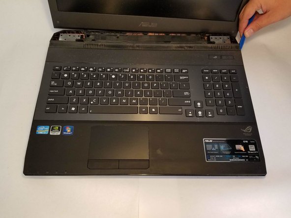

  6. Asus ROG G74SX-DH73-3D Track Pad Buttons Replacement: crwdns2935265:06crwdnd2935265:01crwdnd2935265:02crwdne2935265:0 Asus ROG G74SX-DH73-3D Track Pad Buttons Replacement: crwdns2935265:06crwdnd2935265:02crwdnd2935265:02crwdne2935265:0
    • With the screen removed, pry the piece that has the keyboard and the track pad on it.
  7. Asus ROG G74SX-DH73-3D Track Pad Buttons Replacement: crwdns2935265:07crwdnd2935265:01crwdnd2935265:02crwdne2935265:0 Asus ROG G74SX-DH73-3D Track Pad Buttons Replacement: crwdns2935265:07crwdnd2935265:02crwdnd2935265:02crwdne2935265:0
    • Remove the two Phillips head screws holding the buttons in place.
