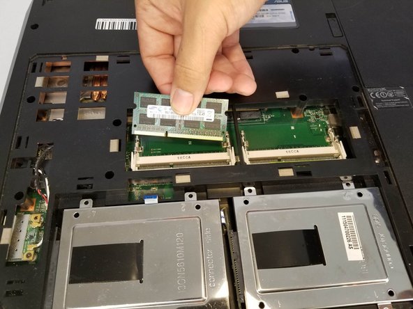

    • Place the device upside down.
    • Unscrew the big metal screw with a flathead screwdriver.
    • Remove the cover using the plastic opening tool.
  2. Asus ROG G74SX-DH73-3D Random Access Memory Replacement: crwdns2935265:02crwdnd2935265:01crwdnd2935265:02crwdne2935265:0 Asus ROG G74SX-DH73-3D Random Access Memory Replacement: crwdns2935265:02crwdnd2935265:02crwdnd2935265:02crwdne2935265:0
    • Pry the clips holding the RAM on both sides.
  3. Asus ROG G74SX-DH73-3D Random Access Memory Replacement: crwdns2935265:03crwdnd2935265:01crwdnd2935265:03crwdne2935265:0 Asus ROG G74SX-DH73-3D Random Access Memory Replacement: crwdns2935265:03crwdnd2935265:02crwdnd2935265:03crwdne2935265:0 Asus ROG G74SX-DH73-3D Random Access Memory Replacement: crwdns2935265:03crwdnd2935265:03crwdnd2935265:03crwdne2935265:0
    • Gently lift the RAM and pull it out.
