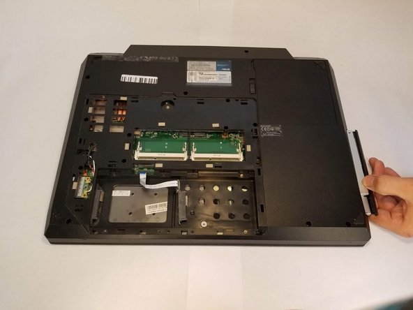

    • Place the device upside-down. Unscrew the screw at the top of the cover and remove the cover by using a plastic opening tool.
  2. Asus ROG G74SX-DH73-3D Disc/Optical Drive Replacement: crwdns2935265:02crwdnd2935265:01crwdnd2935265:01crwdne2935265:0
    • Remove the screw that is located on the right edge of the removed cover. The screw is in a small opening.
  3. Asus ROG G74SX-DH73-3D Disc/Optical Drive Replacement: crwdns2935265:03crwdnd2935265:01crwdnd2935265:02crwdne2935265:0 Asus ROG G74SX-DH73-3D Disc/Optical Drive Replacement: crwdns2935265:03crwdnd2935265:02crwdnd2935265:02crwdne2935265:0
    • Inside the opening that the screw was in, use a nylon spudger or any thin tool to push against the inside edge of the disc/optical drive.
    • With the disc/optical drive slightly popped out of the socket, pull the rest of it out by hand.
