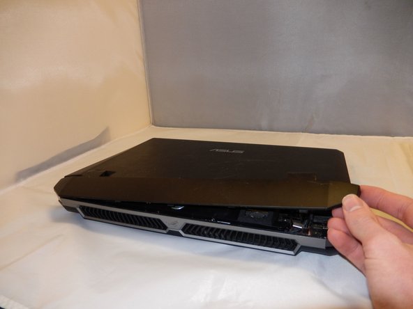

  3. Asus ROG G55VW-DH71 Sound Bar  Replacement: crwdns2935265:03crwdnd2935265:01crwdnd2935265:02crwdne2935265:0 Asus ROG G55VW-DH71 Sound Bar  Replacement: crwdns2935265:03crwdnd2935265:02crwdnd2935265:02crwdne2935265:0
    • Using the iFixit opening tool, gently pry open the plate covering the spine of the device.

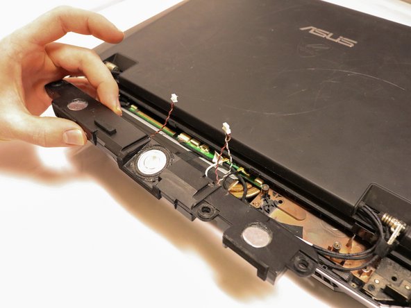

  4. Asus ROG G55VW-DH71 Sound Bar  Replacement: crwdns2935265:04crwdnd2935265:01crwdnd2935265:01crwdne2935265:0
    • Using the PH 00 screwdriver, remove the three 10.6 mm screws holding the sound bar down.
  5. Asus ROG G55VW-DH71 Sound Bar  Replacement: crwdns2935265:05crwdnd2935265:01crwdnd2935265:02crwdne2935265:0 Asus ROG G55VW-DH71 Sound Bar  Replacement: crwdns2935265:05crwdnd2935265:02crwdnd2935265:02crwdne2935265:0
    • Using the bent black tweezers, remove both wires connecting the sound bar to the motherboard.
