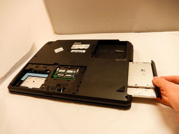

    • Using the PH0 screwdriver remove the 2 3.6 mm screws.
  2. Asus ROG G55VW-DH71 Disk Drive Replacement: crwdns2935265:02crwdnd2935265:01crwdnd2935265:01crwdne2935265:0
    • Lift and remove the back plate.
  3. Asus ROG G55VW-DH71 Disk Drive Replacement: crwdns2935265:03crwdnd2935265:01crwdnd2935265:01crwdne2935265:0
    • Using the PH0 screwdriver remove the 2 4.6 mm screws.
    • Using the PH0 screwdriver remove the 6.6 mm screw.
  4. Asus ROG G55VW-DH71 Disk Drive Replacement: crwdns2935265:04crwdnd2935265:01crwdnd2935265:02crwdne2935265:0 Asus ROG G55VW-DH71 Disk Drive Replacement: crwdns2935265:04crwdnd2935265:02crwdnd2935265:02crwdne2935265:0
    • Pull out the disk drive.
