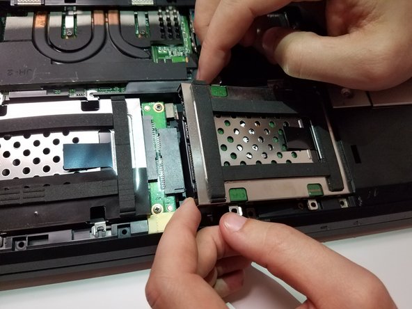

  9. Asus ROG G53SW-XT1 Hard Drive  Replacement, Hard Drive: crwdns2935265:09crwdnd2935265:01crwdnd2935265:02crwdne2935265:0 Asus ROG G53SW-XT1 Hard Drive  Replacement, Hard Drive: crwdns2935265:09crwdnd2935265:02crwdnd2935265:02crwdne2935265:0
    • Place your fingers along the left edge of the hard drive cover, and slide it to the right, then lift up.
  10. Asus ROG G53SW-XT1 Hard Drive  Replacement: crwdns2935265:010crwdnd2935265:01crwdnd2935265:03crwdne2935265:0 Asus ROG G53SW-XT1 Hard Drive  Replacement: crwdns2935265:010crwdnd2935265:02crwdnd2935265:03crwdne2935265:0 Asus ROG G53SW-XT1 Hard Drive  Replacement: crwdns2935265:010crwdnd2935265:03crwdnd2935265:03crwdne2935265:0
    • Remove the Hard Drive and case from the laptop.
    • Remove the four Phillips #0 screws from the hard drive case.
  11. Asus ROG G53SW-XT1 Hard Drive  Replacement: crwdns2935265:011crwdnd2935265:01crwdnd2935265:01crwdne2935265:0
    • Slide the hard drive out of the casing.
