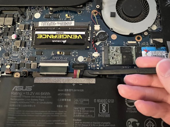

    • Put the tip of Halberd spudger under the battery connector and lift it gently to disconnect it from the motherboard.
    • You may need to wiggle the spudger up and down in order to disconnect the battery connector.

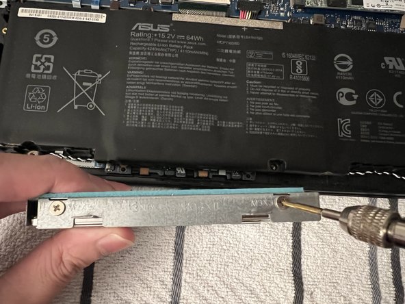

    • Remove the two 3.0 mm screws on each side of the HDD mounting bracket using a Phillips #1 screwdriver.
    • Lift the HDD out of the mounting bracket, and install a new HDD or SSD to the mounting bracket.
After install a new HDD or SSD, for better performace, initialize the new disk.
