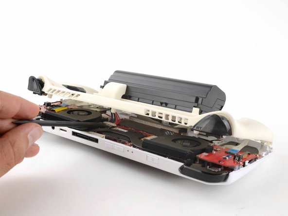

    2. Asus ROG Ally Battery Mod, Insert an opening pick: crwdns2935265:03crwdnd2935265:01crwdnd2935265:03crwdne2935265:0 Asus ROG Ally Battery Mod, Insert an opening pick: crwdns2935265:03crwdnd2935265:02crwdnd2935265:03crwdne2935265:0 Asus ROG Ally Battery Mod, Insert an opening pick: crwdns2935265:03crwdnd2935265:03crwdnd2935265:03crwdne2935265:0
      • Insert the flat edge of an opening pick between the bottom edge of the back cover and chassis, near the captive screw.
      • Angle the pick upward and push it under the back cover.
    3. Asus ROG Ally Battery Mod, Release the back cover's clips: crwdns2935265:04crwdnd2935265:01crwdnd2935265:03crwdne2935265:0 Asus ROG Ally Battery Mod, Release the back cover's clips: crwdns2935265:04crwdnd2935265:02crwdnd2935265:03crwdne2935265:0 Asus ROG Ally Battery Mod, Release the back cover's clips: crwdns2935265:04crwdnd2935265:03crwdnd2935265:03crwdne2935265:0
      • Plastic clips secure the perimeter of the back cover. You should feel and hear them release during this step.
      • Slide the opening pick along the bottom edge and around the corners of the back cover to release the clips securing it.
      • Keep the pick at an upward angle under the back cover to help release the clips.

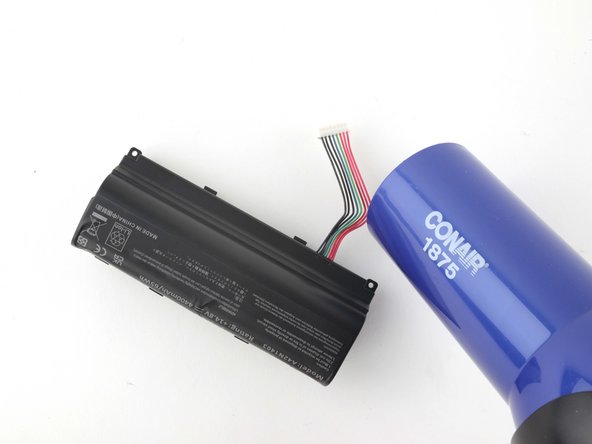

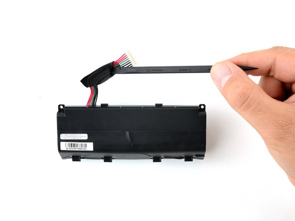

    3. Asus ROG Ally Battery Mod, Prepare replacement battery connector: crwdns2935265:014crwdnd2935265:01crwdnd2935265:03crwdne2935265:0 Asus ROG Ally Battery Mod, Prepare replacement battery connector: crwdns2935265:014crwdnd2935265:02crwdnd2935265:03crwdne2935265:0 Asus ROG Ally Battery Mod, Prepare replacement battery connector: crwdns2935265:014crwdnd2935265:03crwdnd2935265:03crwdne2935265:0
      • Remove the black tape around the wires on the A42N1403 battery.
      • Do not use any metal tools to avoid unintentional damage to the battery.
      • Position your hair dryer in a way that directs heat towards the connector but away from the battery.
      • Do not apply heat to the battery pack! Ensure that the hot air is always directed away from the battery.

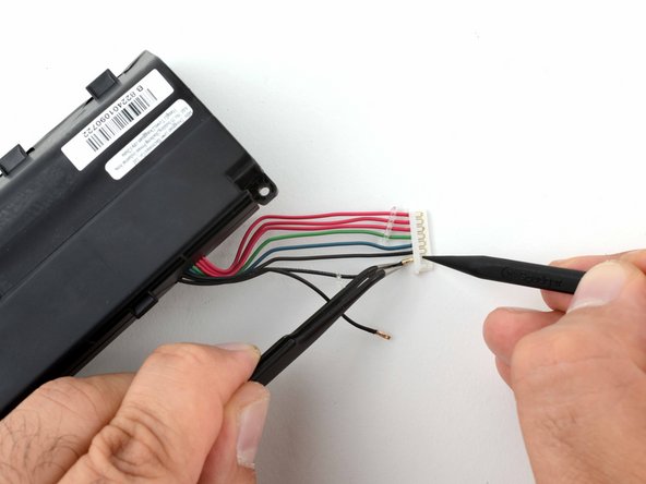

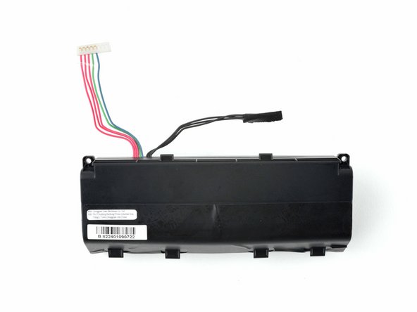

    4. Asus ROG Ally Battery Mod, Remove the black wires: crwdns2935265:015crwdnd2935265:01crwdnd2935265:03crwdne2935265:0 Asus ROG Ally Battery Mod, Remove the black wires: crwdns2935265:015crwdnd2935265:02crwdnd2935265:03crwdne2935265:0 Asus ROG Ally Battery Mod, Remove the black wires: crwdns2935265:015crwdnd2935265:03crwdnd2935265:03crwdne2935265:0
      • Pry away the glue at the base of the connector.
      • It is possible to remove the glue without applying heat but the risk of damage to the cables increases.
      • Use a spudger to lift the plastic tabs on the connector and remove the black wires.
      • Tape the three black wires together.
      • Make sure the ends of the red wires don't touch any of the other wires. This could damage the battery circuitry.

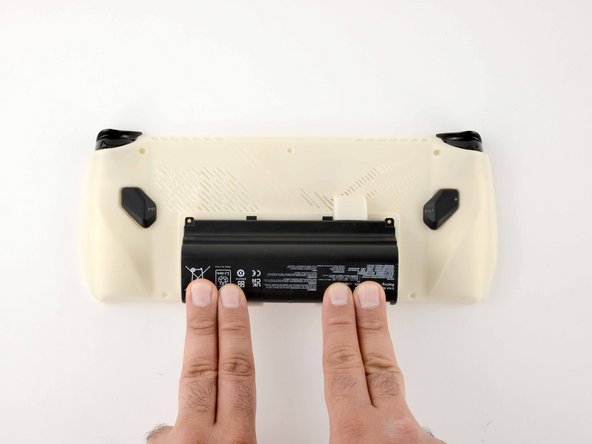

    7. Asus ROG Ally Battery Mod, Install a new battery: crwdns2935265:018crwdnd2935265:01crwdnd2935265:03crwdne2935265:0 Asus ROG Ally Battery Mod, Install a new battery: crwdns2935265:018crwdnd2935265:02crwdnd2935265:03crwdne2935265:0 Asus ROG Ally Battery Mod, Install a new battery: crwdns2935265:018crwdnd2935265:03crwdnd2935265:03crwdne2935265:0
      • Pass the battery cable through the opening in the new back plate.
      • Turn the connector head 180 degrees so the small white tabs are facing towards the mainboard.
      • Ensure the battery is correctly positioned and firmly press down on the base of the battery pack until you hear a click.
      • Check to ensure both case clips are engaged against the battery clips.
      • With the back plate loose, you need to carefully connect the battery connector and slide the metal bracket into its locked position.
      • This step is a bit fiddly but take your time and you'll get it to work.

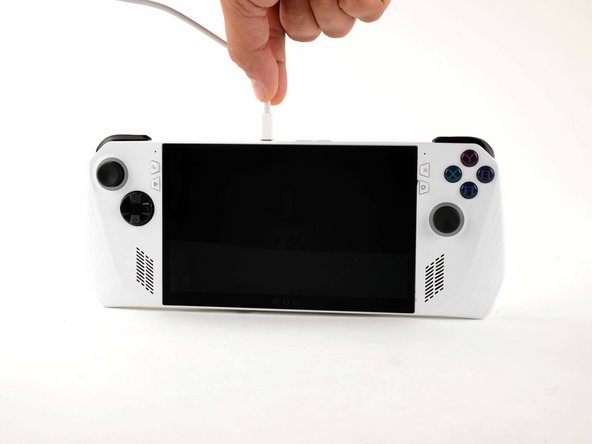

    8. Asus ROG Ally Battery Mod, Boot from mains: crwdns2935265:019crwdnd2935265:01crwdnd2935265:03crwdne2935265:0 Asus ROG Ally Battery Mod, Boot from mains: crwdns2935265:019crwdnd2935265:02crwdnd2935265:03crwdne2935265:0 Asus ROG Ally Battery Mod, Boot from mains: crwdns2935265:019crwdnd2935265:03crwdnd2935265:03crwdne2935265:0
      • You can replace five of the original six screws used to secure the backplate.
      • Use two of the screws from the original battery pack to further secure the new battery.

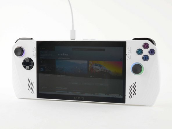

      • Plug in your ROG Ally to its power supply.
      • The ROG Ally will not power on after the battery has been disconnected without mains power.
      • Your ROG Ally should now be able to run off the new battery pack.

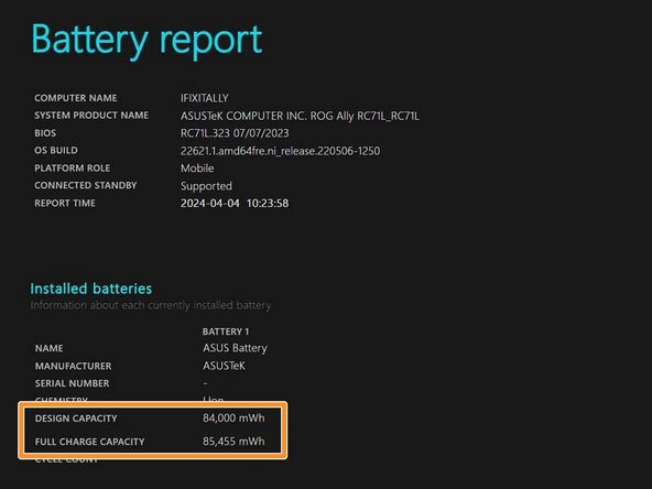

    9. Asus ROG Ally Battery Mod, Check battery stats: crwdns2935265:020crwdnd2935265:01crwdnd2935265:02crwdne2935265:0 Asus ROG Ally Battery Mod, Check battery stats: crwdns2935265:020crwdnd2935265:02crwdnd2935265:02crwdne2935265:0
      • You can check the status of your new battery by opening PowerShell in Admin mode and typing: powercfg /batteryreport /output "C:\report.html". The report will be saved to your C: drive with the given filename.
      • OEM battery pack capacity.
      • Upgraded battery pack capacity.
      • Game on.
